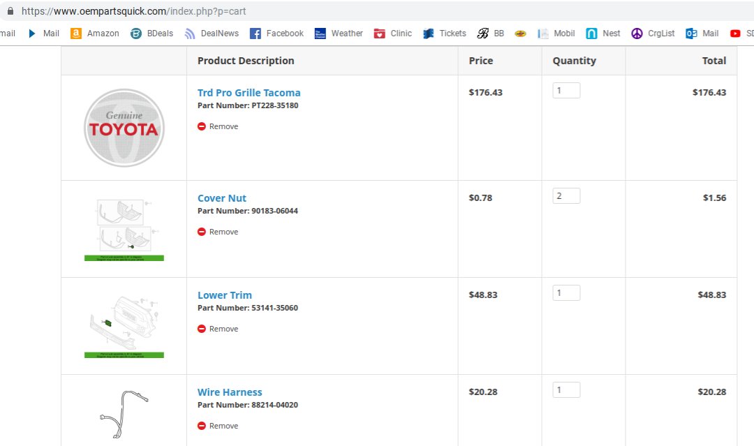

    OEM is not that much more expensive.
    I bought mine here, totals about $250 and they charge reasonable shipping.
    You just have to get a VIN from a TRD Pro.

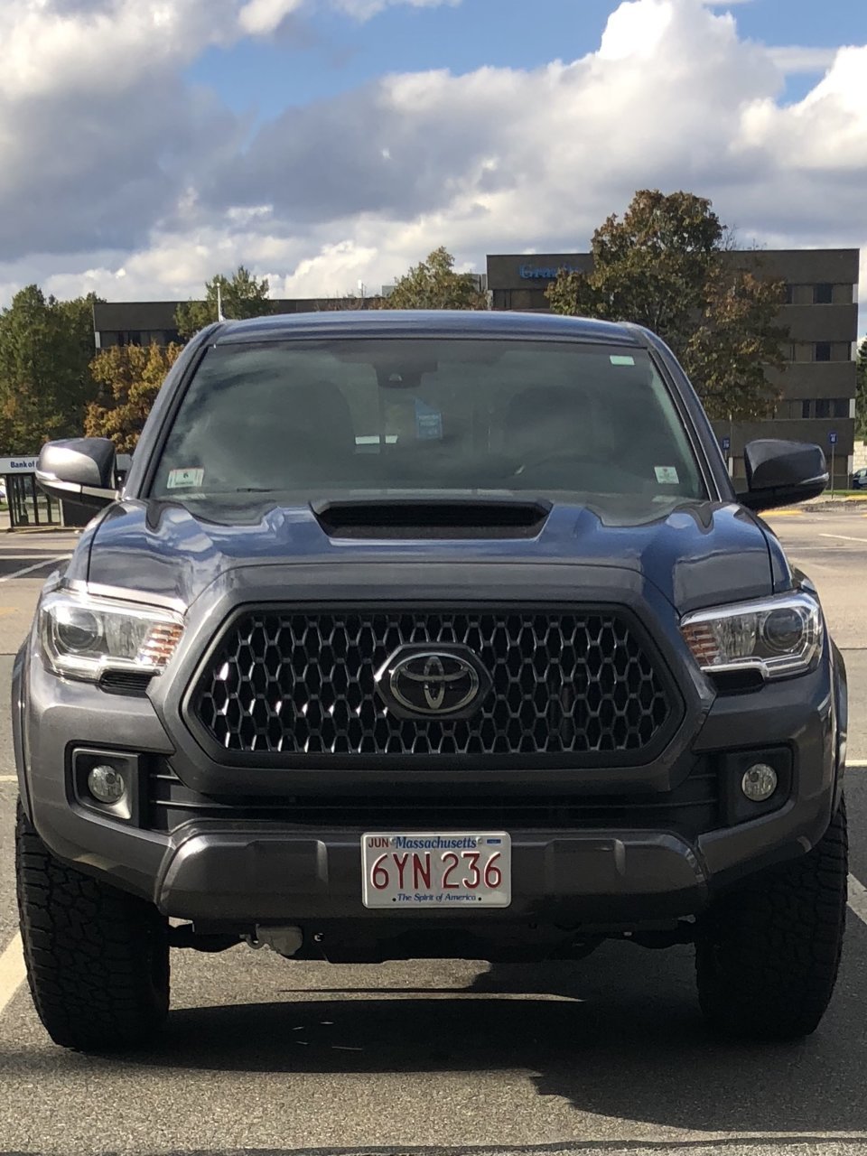

    This is the route I am taking too.
    Love the look of the PRO grille, but changing to the SR bezel is cheaper, easier, and even more distinctive. The fact they toned down the chrome look on the OEM OR/Sport grille helps a lot too.
    It's great that we have choices! No wrong answer here, and no one should feel compelled to justify their choice, and certainly should not be questioning others' choices.

    I went to oempartsquick website and searched under 2018 tacoma pro. it shows this grille part number 53101-04050-C0 with the option of black, blue or white. also it's 25.00 cheaper. does anybody have any insight into this?

    Haven't heard of the other colors, but keep in mind the cheaper 18 oem grills have an opening at the bottom for radar requiring the garnish piece. The older 17 oem and the ebay ones come with a plastic filler plate for if you don't have tss.

    cool - that pays for half of the garnish part!

    now that I look at this closer it looks like this p/n includes the grille surround. that is why there is a color choice!
