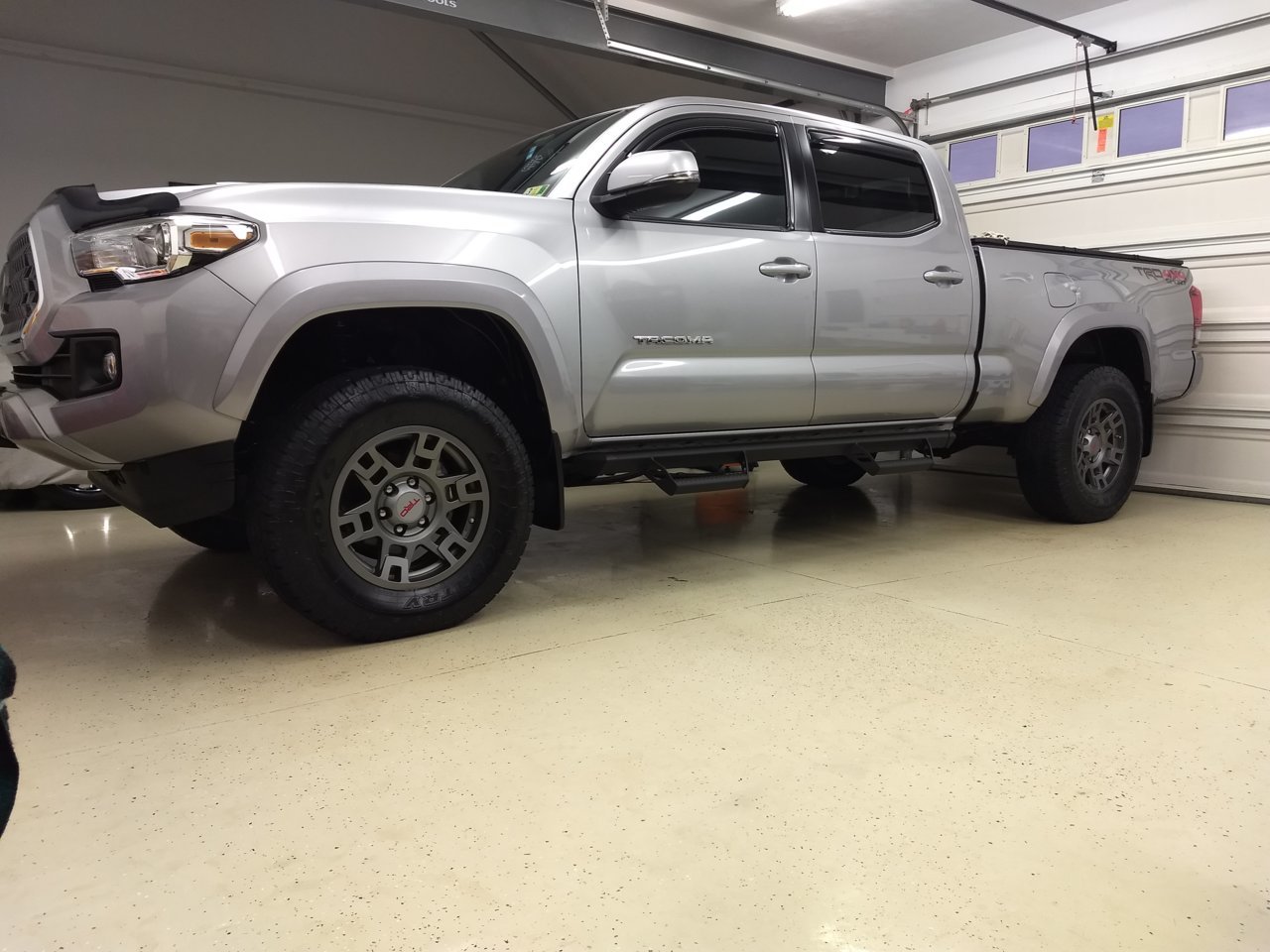

    I got an OEM TRD pro grill for my 18 but haven't put it in yet. Waiting to do it on the Christmas break. Will I need the longer wire harness? I ordered it and I have to fo to the dealership and pick it up. I think it will look good on my recenlre lifted dclb.IMG_20181216_145744099.jpg

    What wheels are those? They super clean!

    Thanks. They are the 16 inch Tacoma pro wheels.

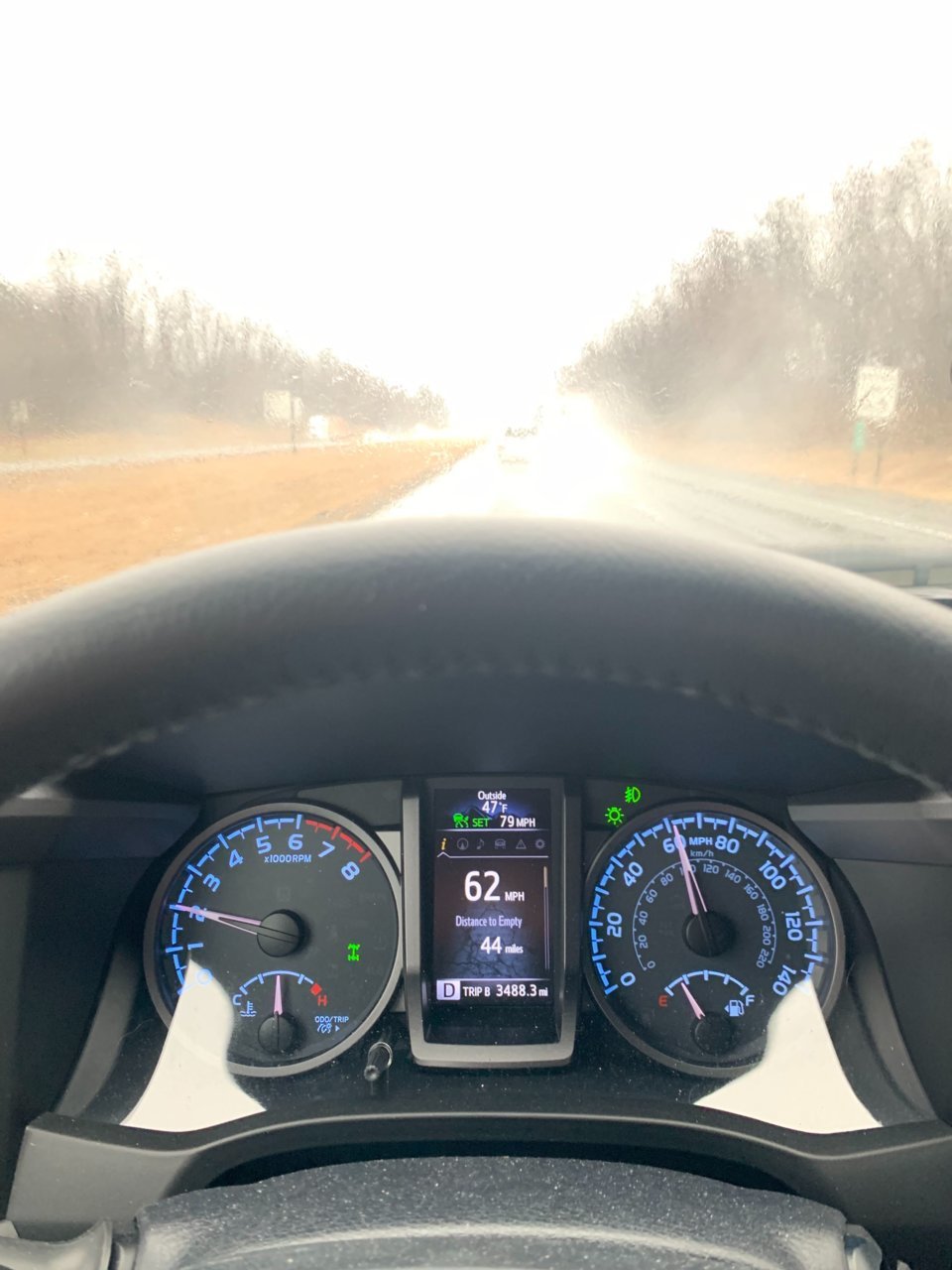

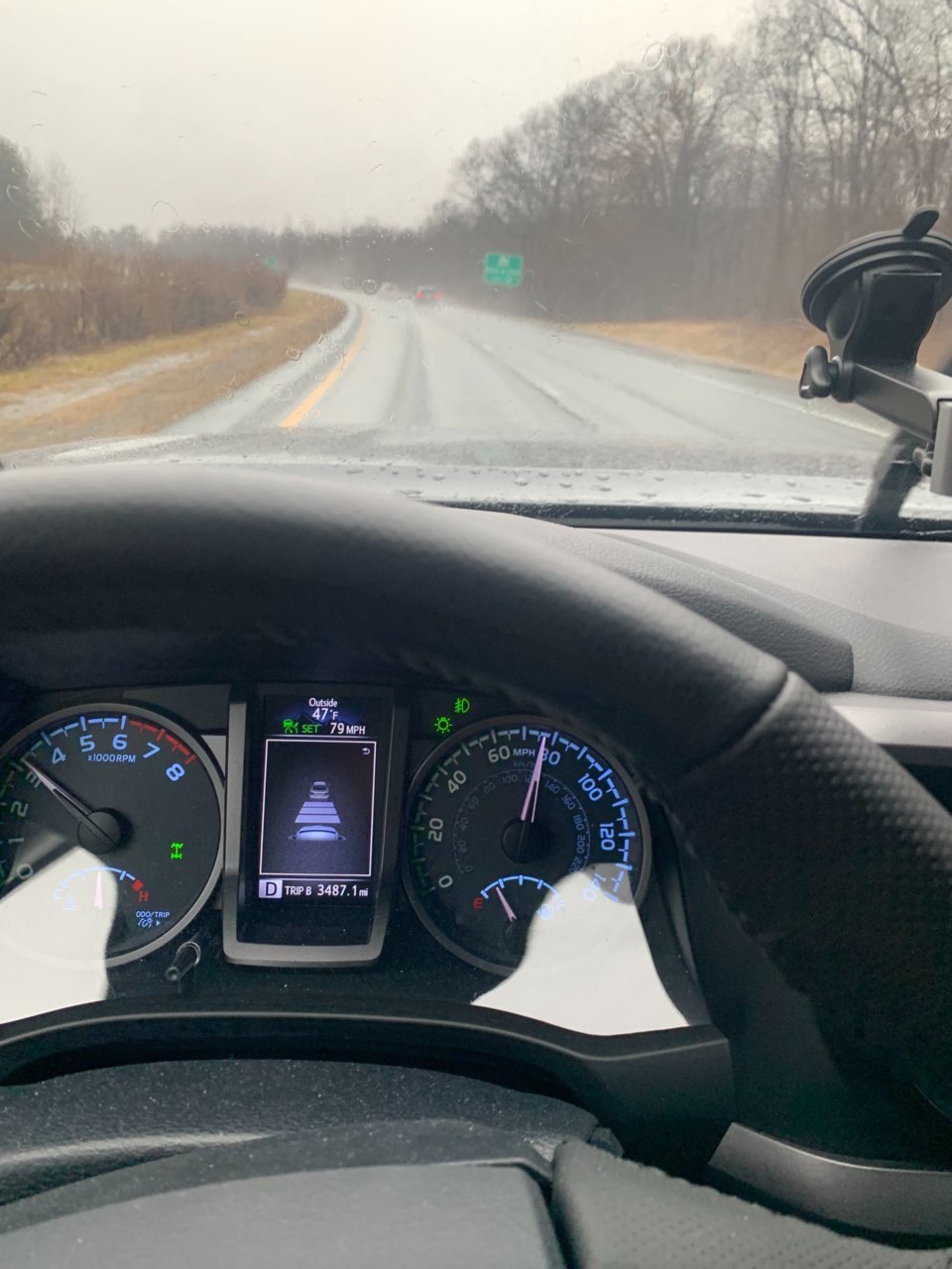

    Just thought I'd post an update with some pics. I made a trip up north in crappy weather and had zero problems with my faux pro grill and garnish. Worked perfectly the entire trip, sped up, slowed down, stopped, etc. all without throwing any errors.

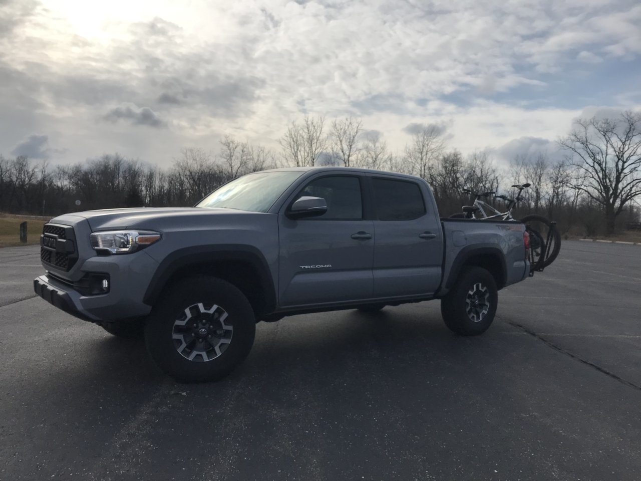

    Love the wheel choice. Any updated pics with the new grill installed.

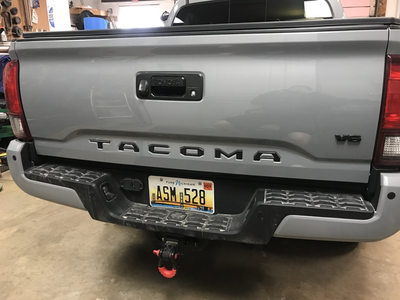

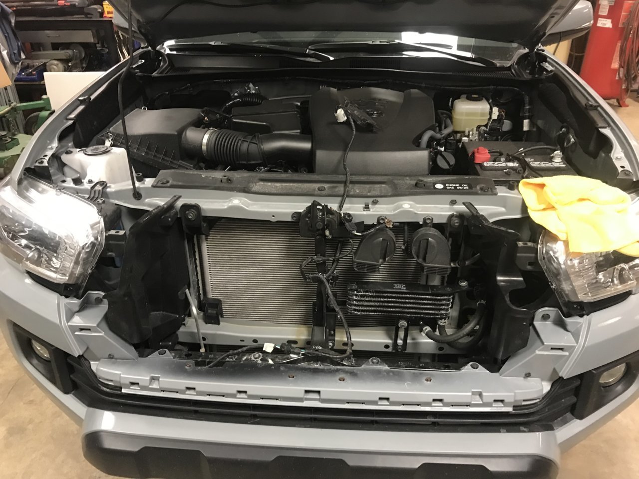

    Finally getting time to add photos. I went around and around with the dealer trying to get a OEM grille. You have to have a PRO vin number. However it made my truck look 210% better!!!!! I love it. Only took about 20 mins to install.
    OEM Grille—-Dealer: $240
    OEM Garnish—-eBay: $51
    Also added the Eye Catcher lettering to the Tailgate.
