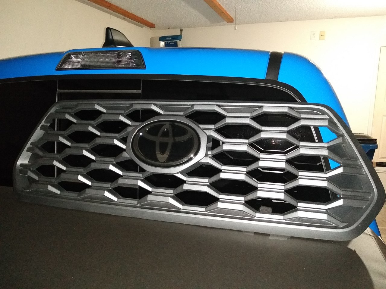

    This is my truck with the OEM grille:
    This is my truck with the heritage grilled:
    The TSS sensor is behind the oval and easily removable so you can add it to the aftermarket grille. There are YouTube videos how to do it. You can do it yourself in under 15 minutes.

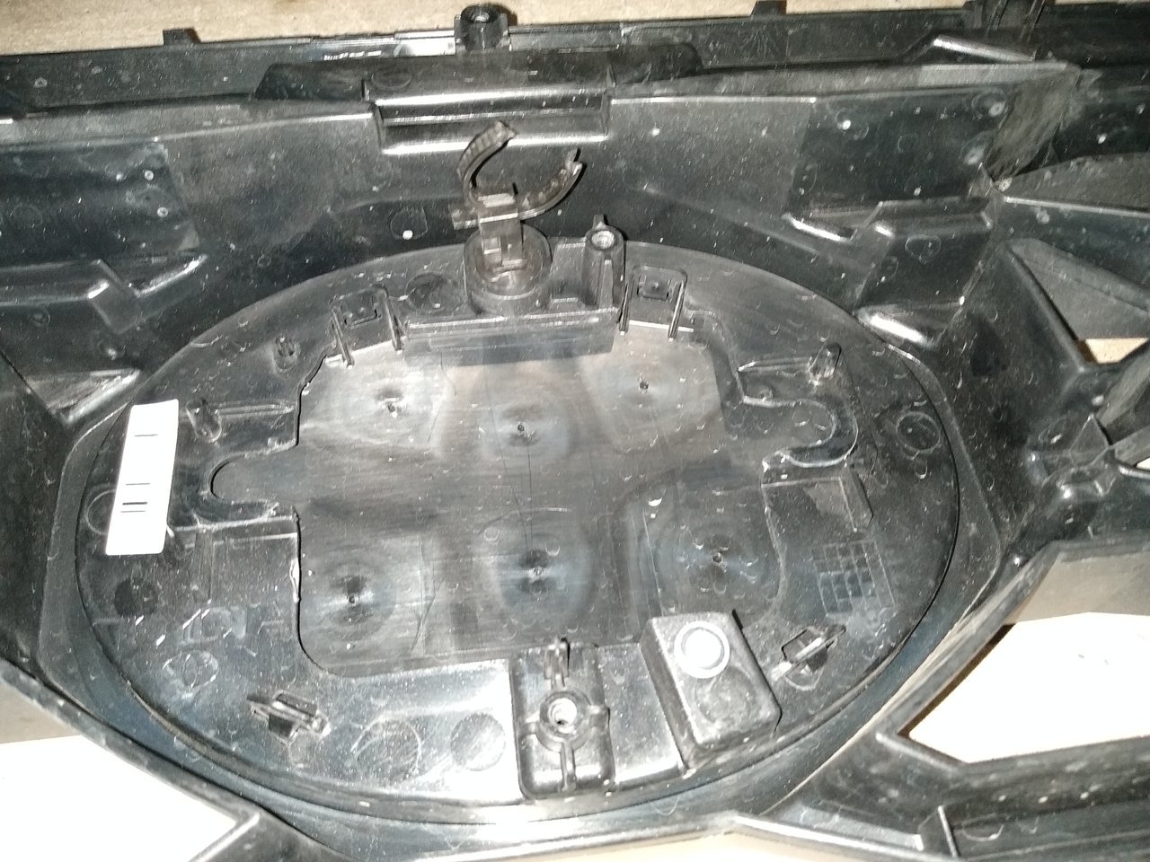

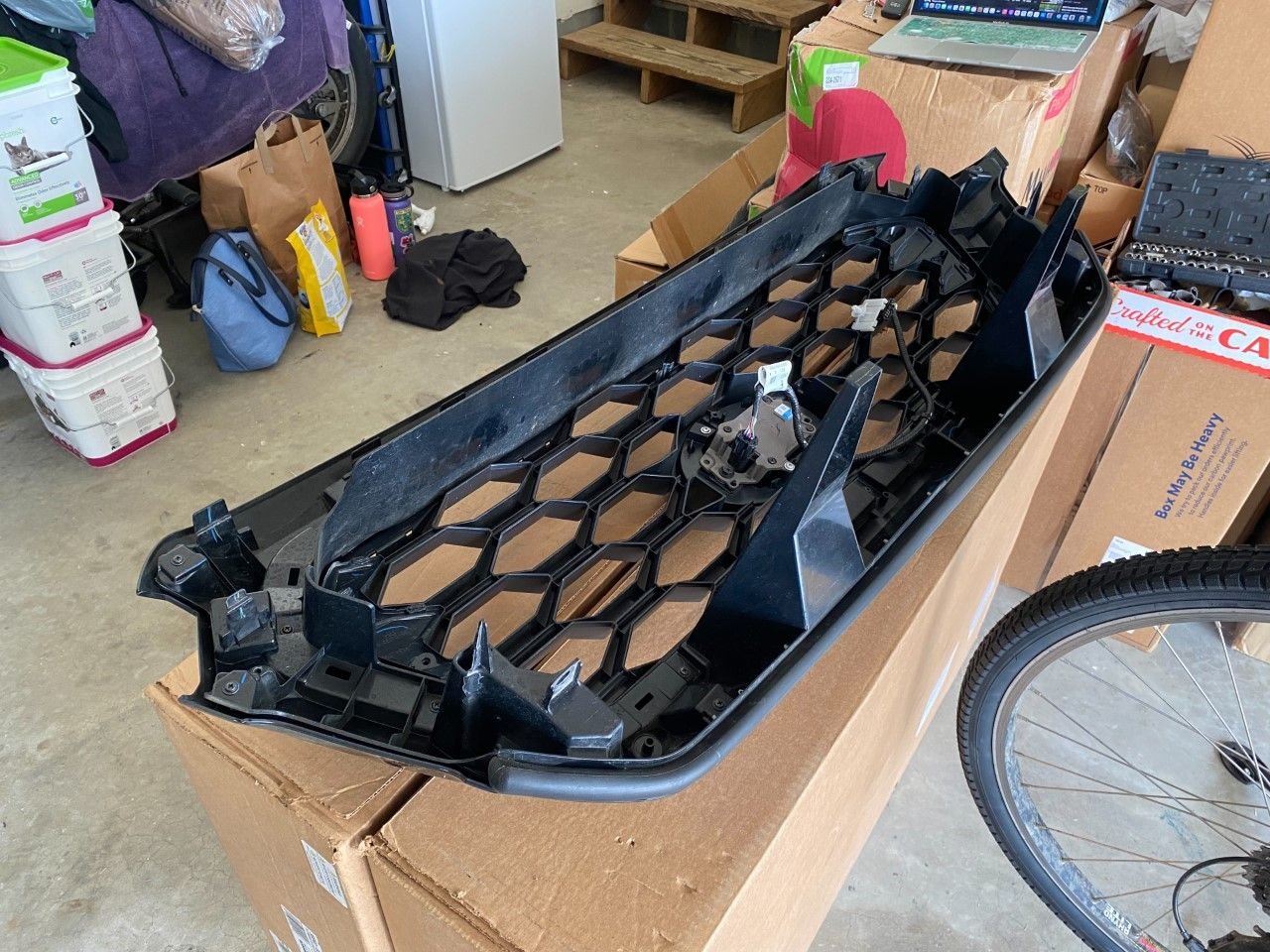

    The Toyota oval IS the TSS sensor. Get it? It's wired up and hidden behind the logo.
    This is what is behind the grill & oval:

    ok this might be another horribly dumb question -- but are the TSS sensor and the parking sensors different?
    i'm just wondering if i have the TSS sensor wired into my truck by default. what connection / sensor am i missing for the parking sensors? and can those be installed aftermarket

    The TSS sensor is for braking. The parking sensors (BSM) are totally different. All Tacoma's come with TSS installed, but the BSM/Parking sensors are an option/package that you must pay extra for.
    You do have the TSS wired into your truck right now. It is behind the black Toyota oval badge in your grille.

    So, just to get the emblem off, I still have to take off the whole grill? But it looks like the TSS is NOT actually connected to the emblem, so just the single screw and 2 tabs to release the emblem?
    Maybe, if the grill has to come off to do the front end repair, I'll get the guy to hand me the emblem to cover.
