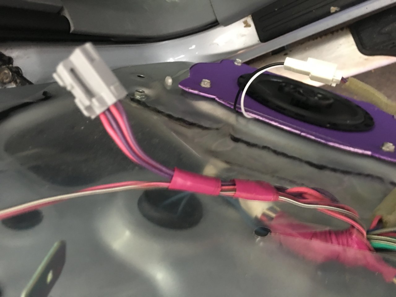

    What’s my best option? Is it to reuse this harness on the factory tweeter? F506FEB6-5B59-4A17-9EB0-63FBE86ACE16.jpg
    Does anyone have experience wiring 2nd gen tweeters, I couldn’t find a lot of good info on it. I will make a plastic housing for the tweeter, just curious about the wiring.Thank you

    Just splice the factory connector onto the new one.

    Haven’t done wiring in a while, last wiring I did was house electrical wiring. Would you use a wire nut for the connection?

    I made a flat bar of aluminum with a center hole to mount my pioneer tweeters to, I chopped the factory harness and used that.
    DO NOTE. that the polarity of the stock tweeter is REVERSED. that is, on that lil harness that goes to the tweeter, the black is positive and red is negative. (Just follow the wires back to the main harness and you will understand what im talking about) I have been told that this was (on the stock system) to create a "larger sound space". When i put in my aftermarket door speakers and aftermarket tweeters I wired them up with positives all together like you normally would.
    Proper crimp connector
    Benny123 likes this.

    So did you wire red to red and black to black or red & black

    It will be backwards. But double check. Follow the positive and negative from the door harness side (the non black and red wires) and disregard the colors on the stock tweeter side harness and hook them up properly to the positive n negative of the aftermarket tweeter.

    Solder the two wires together with heat shrink over the top of each. No way on wire nuts.

    Thank you very much guys, I am still very confused about the tweeter wiring negative positive. Using the default harness do I wire black to red and red to black? I haven’t messed around with any blue or pink wires

    Do you have a wiring diagram of what is what (as far as positive and negative color wise) for the main speakers on the door harness. If so follow the positive on the door harness side to the connector for the tweeter, im 99% sure that the positive on the door harness side goes to the black of the lil tweeter harness. Double check me.
    But if thats the case id recommend taking the stock tweeter harness and going black of the harness to positive of the aftermarket tweeter.

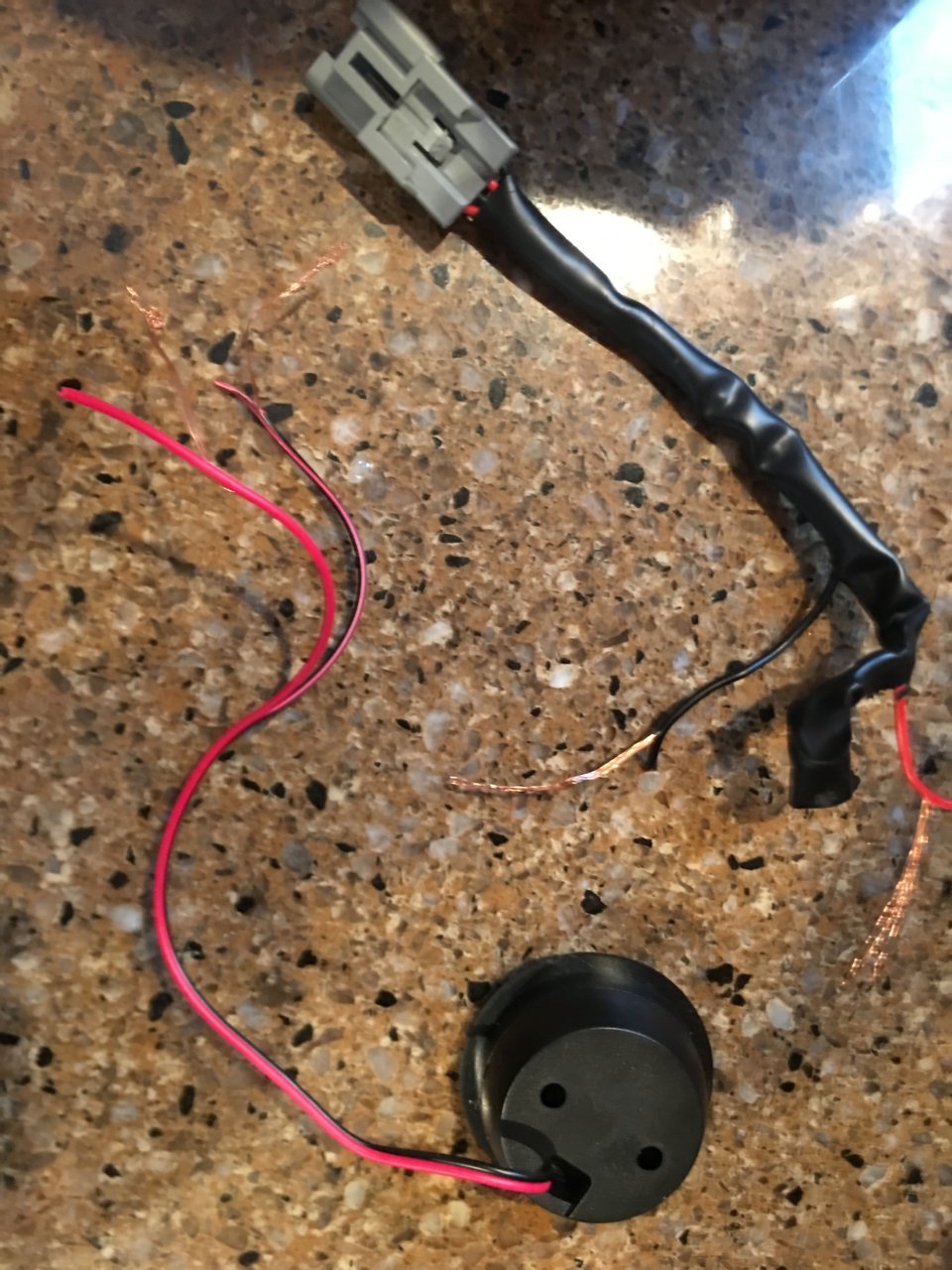

    2EBD4AA4-097C-473B-B679-6C678FB26CE8.jpg E285D855-55D7-4026-8F16-57DB967BC143.jpg
    I took the splice apart because I am very confused about the wiring now

    Pull the black sheeth off of the tweeter side harness. There are 2 blacks and 2 reds off the grey plug. Make sure to attach both of the matching colors off the grey plug otherwise you wont get any signal to the main speaker.

    Okay I think I understand, does it make a big difference and is it worth doing for my Rockford Fosgates
