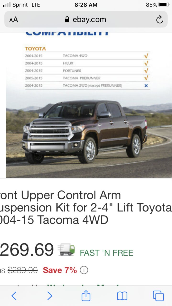

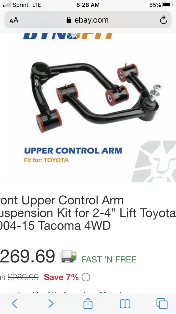

    https://www.ebay.com/itm/Front-Upper-Control-Arm-Suspension-Kit-for-2-4-Lift-Toyota-2004-15-Tacoma-4WD/254337565726?fits=Year%3A2010%7CMake%3AToyota%7CModel%3ATacoma%7CTrim%3APre+Runner+Crew+Cab+Pickup+4-Door%7CSubmodel%3APre+Runner%7CEngine%3A4.0L+3956CC+241Cu.+In.+V6+GAS+DOHC+Naturally+Aspirated%7CEngine+-+Liter_Display%3A4.0L
    2
    010 tacoma prerunner 2wd with 2 inch lift and 285 size tires
    symptoms- wondering on roadway slight jerking in steering.
    Shop told me a month back on alignment that caster /chamber was maxed out. Not 100% sure which one he said but one of them.
    was told these would deff help.
    opinions please?? My budget is limited.

    I sent a pic and link of ones I’ve found. And they are greatly priced. Above. Looks to best priced ones i see !

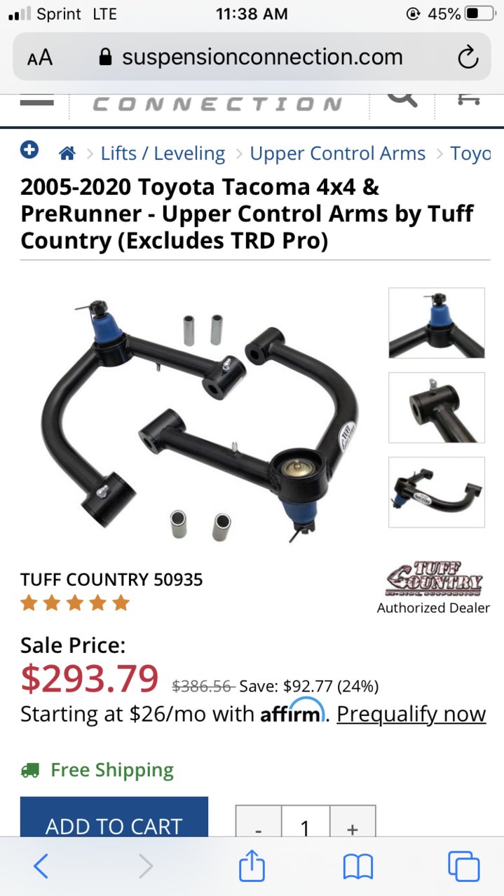

    These are my next option. But will not spend no more than this amount. I just honestly can’t afford. It to be more than this

    FWIW, most people on here are all gonna say go with spc, jba, total chaos, etc.
    Ultimately all these were over priced for me and the freedom off road($300) had been mentioned on Tacoma world before with out any negative reviews from people who actually used them. I would try to find reviews and check out the warranty policies before picking a set and make sure the ball joints and bushings are replaceable so if one starts to wear out you’re buying new control arms again .

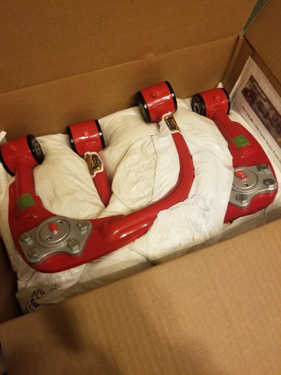

    I just got jbas havent installed them. Also had the spc ucas that's currently on my truck. Jbas ftw
