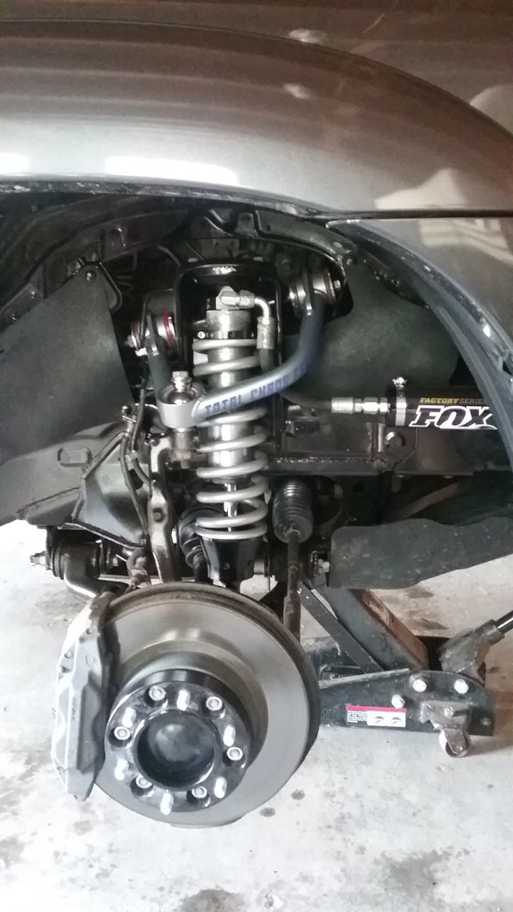

    20170719_153656.jpg here is mine

    What UCA's are those?

    doesnt surprise me.... some uniballs dont have much if any more flex than the standard ball join (around 60*). It looks like they re-angled the cup some to help with droop, but not as much as say TC, and it looks like a smaller 1in uniball which will have less flex too.
    Are you running any spacers on the top of struts?
    ChadsPride likes this.

    yea these are a 1" uniball.
    No spacers, just 5100's with 885 springs.
    Thanks for the replies guys!

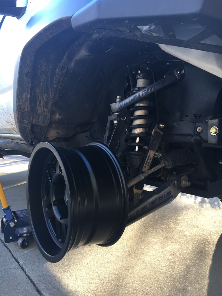

    Mine at full droop.

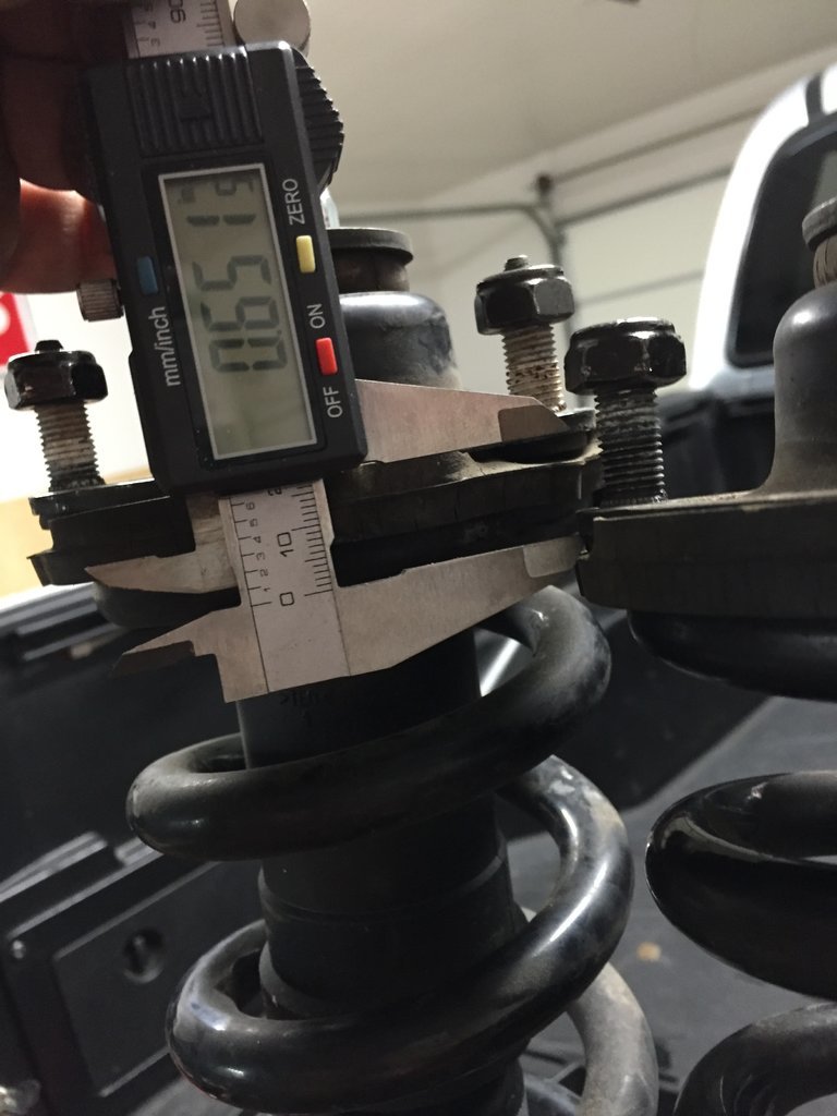

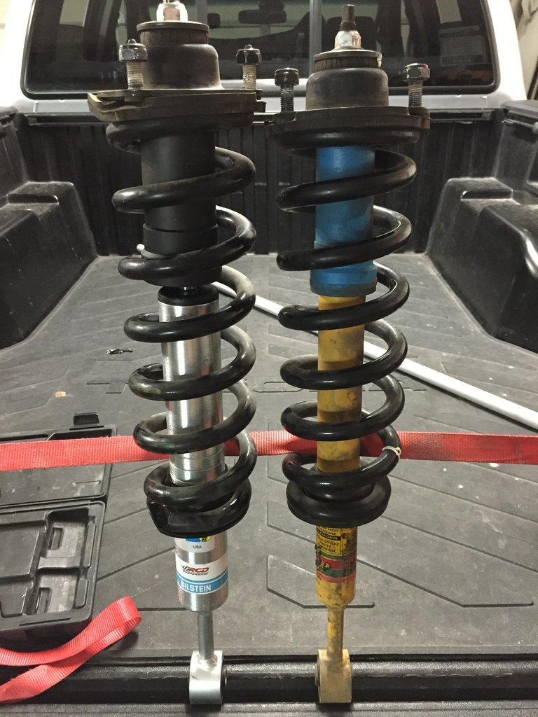

    Closer to 5/8" longer than the stock Bilsteins.
  13. Jul 19, 2017 at 8:00 PM
    Justinlhc
    Justinlhc Not looking for a relationship
    Jul 7, 2015
    #158945
    3,512

    ah yes.... i got my droop at the tire measurement mixed with the shock length. looking around 1.5in more droop than stock, which translates to right around 5/8ths - 3/4in at the shock.
