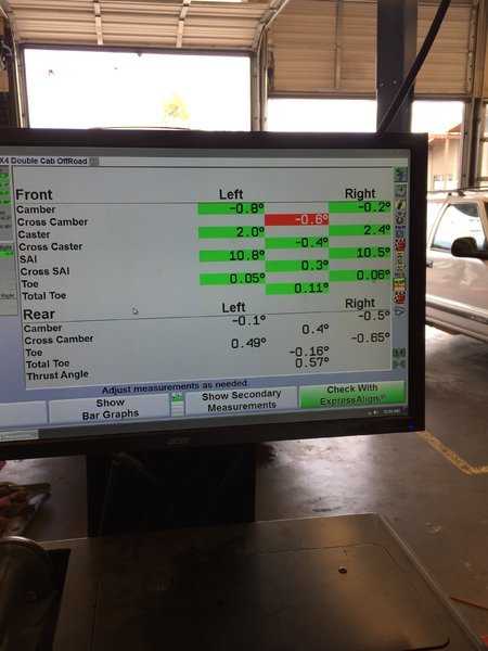

    DSM is where I got my Camburgs a few years ago and they cost $641 at the time. Still have them and I have never had a problem w/ them. Like stated above, keep the Uni ball clean. Also grease the bushings when needed. I get great alignment #'s w/ them and probably could get better. But it's up to you. GL!
