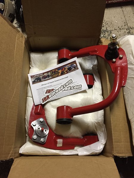

    JBA doesn't make them for first gens unfortunately, I don't think so anyway

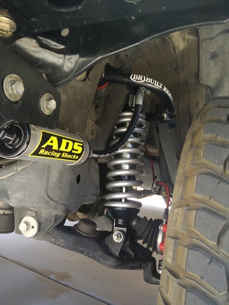

    I got my built right uniball uppers for $470, uniball aren't always $300 more expensive
