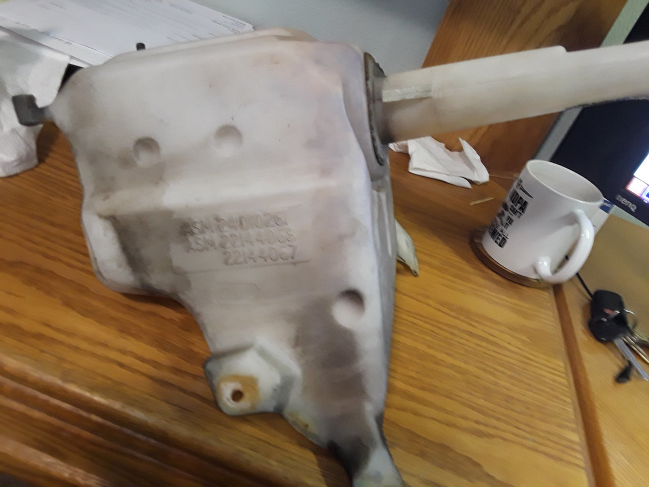

    For anyone interested, pulled mine today, here is what it looks like, as you can see it requires the huge hole in the bottom for the fluid level sensor. It is stamped "Valeo Made in Canada" and the numbers printed on it mean nothing (probably mfg #'s)

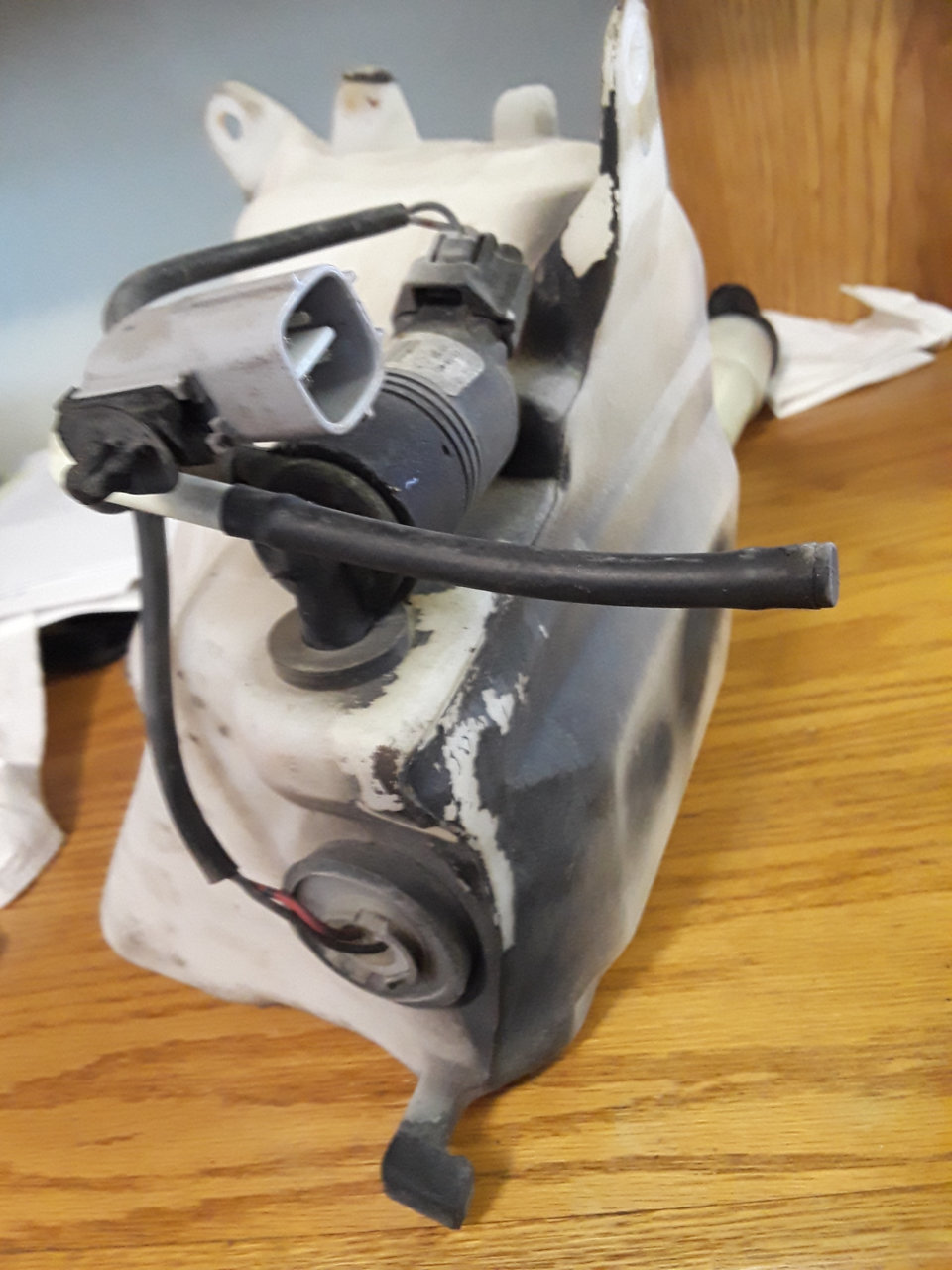

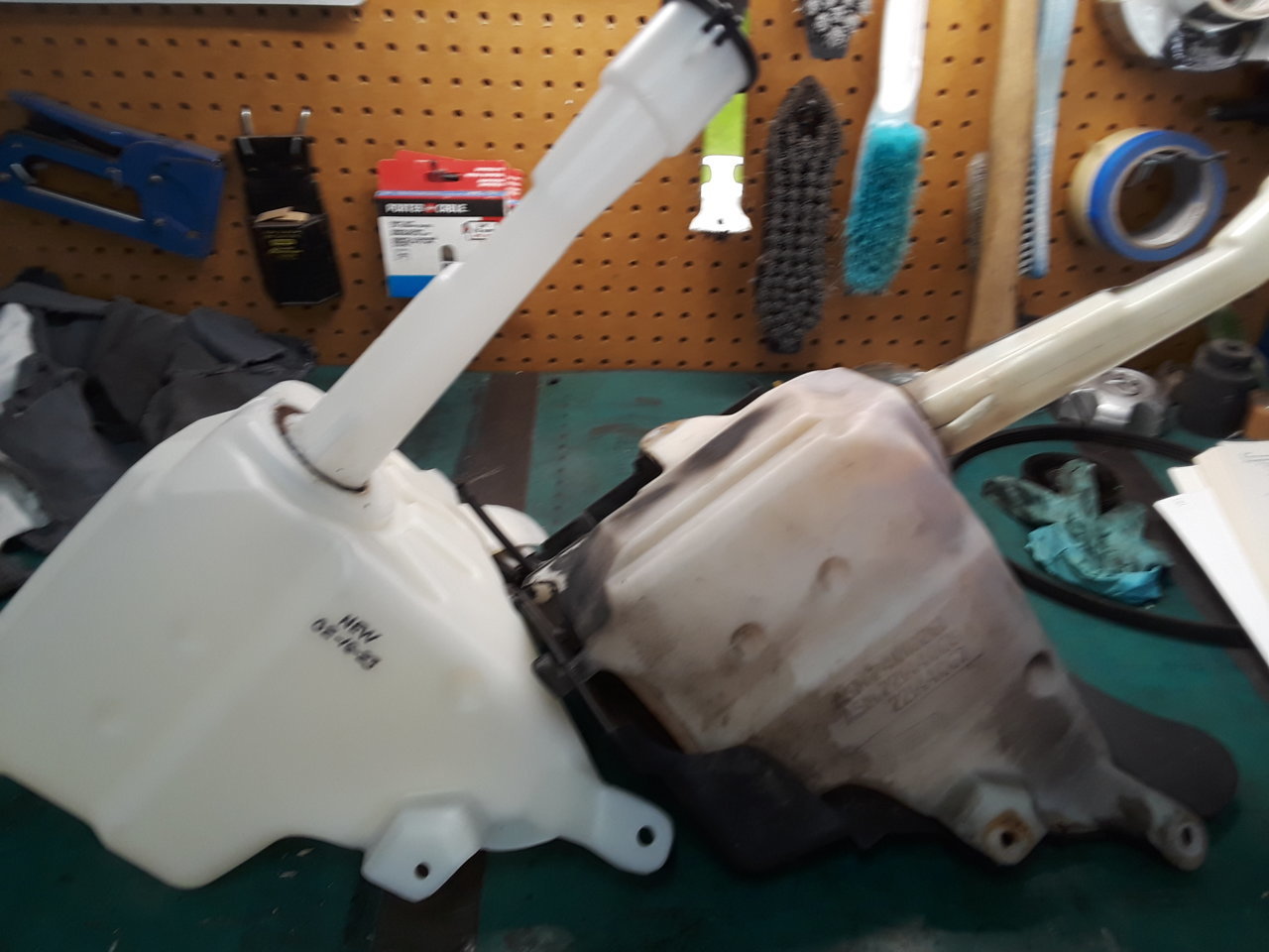

    The upper grommet is a plug, probably for some other application. This one came with a cap and pump but no sensor, fill screen or connection fittings, used those from the original along with the heat/mud shield. The neck does come separate from the tank, seen here. Otherwise good fit.

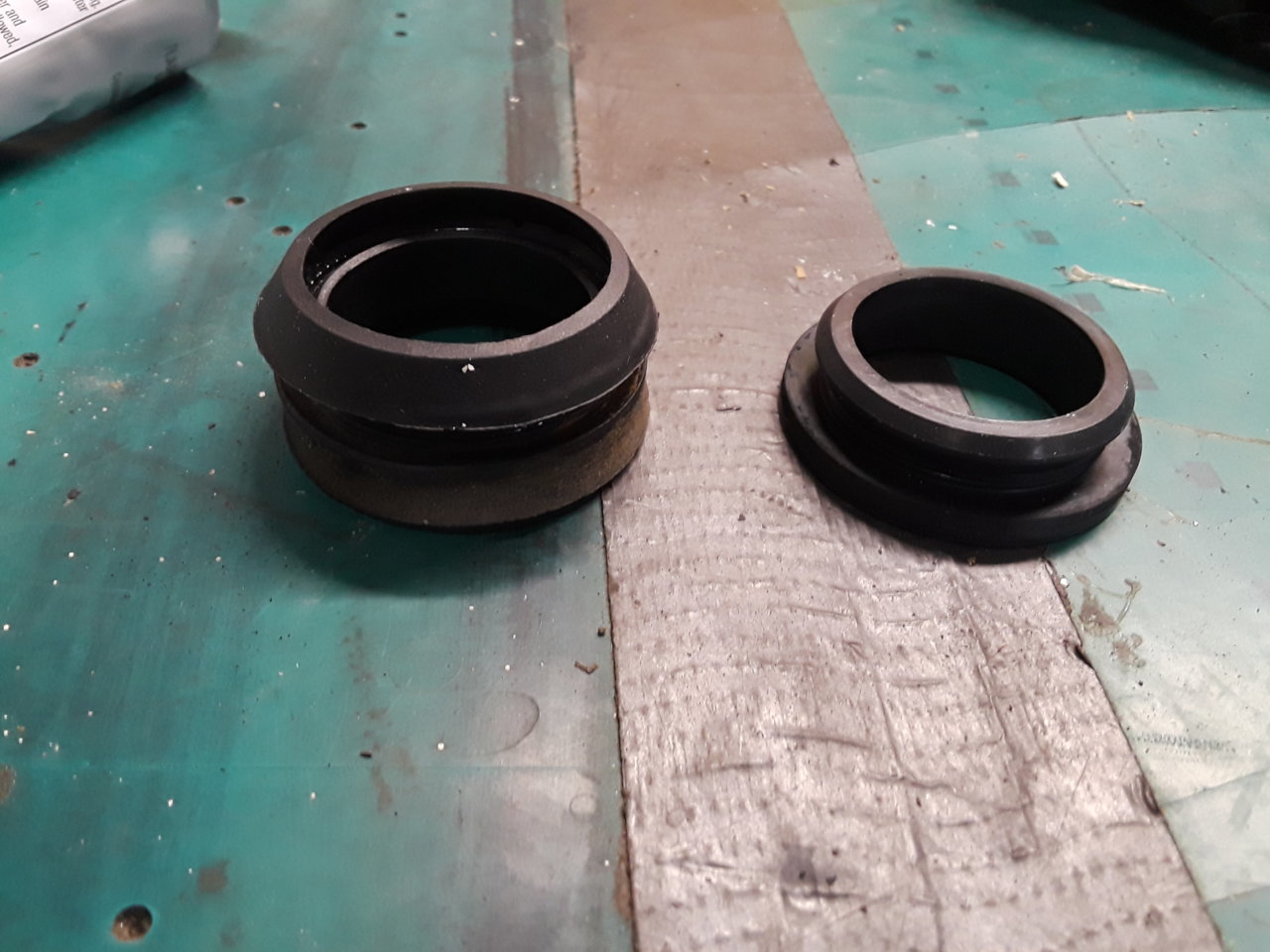

    The sensor gasket is a bit skinny (right) compared to the original (left.) I used it anyway and wet-tested before installing. I also ran some Goop around both the sensor hole and the neck joint. Saving this gasket, for a 20 year old truck the rubber seems really pliable.
    Pump appears fine. On testing I noticed one of the nozzle sprays wasn't working, hadn't noticed before. I have some piano wire about the thickness of a G string (on a guitar) and ran it through the nozzle a few times, took ten minutes. Five of that was horsing around figuring out how to pop the nozzle off the hood lol
