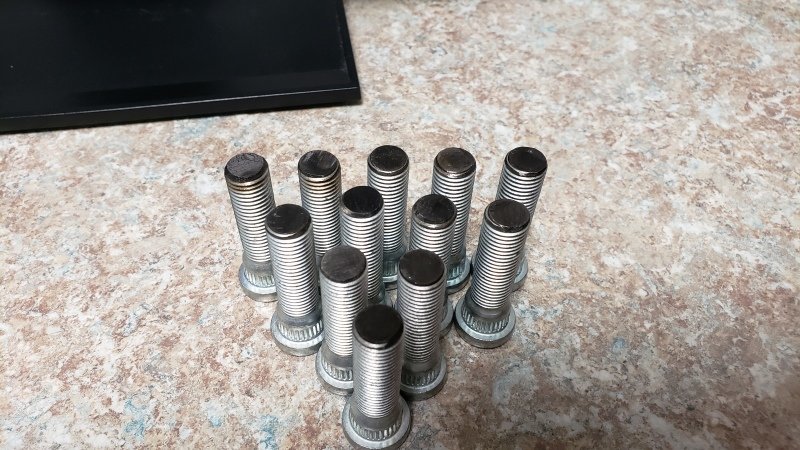

    Thanks for the link, but thankfully mine are done.
    My lugs were only getting 5 threads of purchase on the OEM studs.
    I ordered H&R's and cut them down.
    OEM on the left, H&R on the right.
    drizzoh[QUOTED] likes this.

    Man you cut those down A LOT lol. I run the H&R 50mm's on my tC for the same issue and they're nice. Didn't even think to check if they fit the Taco when I installed my RAYS. You'd think wheels designed for this platform would be able to properly install on the factory lugs.. but whatever I'm over it now. Was just frustrated with the luck I've had with the truck and ordered from the first site that came up lol.
    I debated cutting the wheeladapter.com ones down, but it was easier to drill a hole in the rear dust shields. Up front wasn't a big deal, the splash shields bent out of the way pretty easily.

    ^My thoughts exactly.
    My Venomrex wheels weren't even machined to accept XL lugs.
    The XL's might have been enough to ease my mind, but as it was, stud replacement was the only option.
