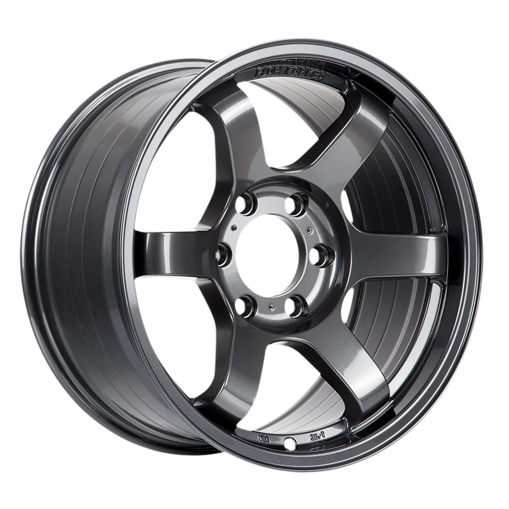

    Any wheel manufactures with 95.1 Hub Center Bore wheels?

    Camburg LT kit DMZ SUA kit SCS wheels Destroyer Gray
    We're hoping to have ours available late summer!

    Icon Alloy Wheels has some 95.1 center hub wheels. However because the 106.1 that fits the Gen3 Tacoma are more common, there are hub rings to reduce from 106.1 to 95.1.

    Your Five Star Flow will work on 24 Tacoma TRD OR with a 95.1 Bore?

    Yes, the 17x9" +25 6x139.7 Five Star Flow Formed wheels will fit great on a 2024 Tacoma TRD Offroad. The wheels will be hub centric on your truck.
    This particular version is 9" wide, so the minimum tire size I would recommend is 265/70R17.

    Here are just a few more options in the G-FX line. TR-27, TR-24, TM8, and TR29.:thumbsup:
