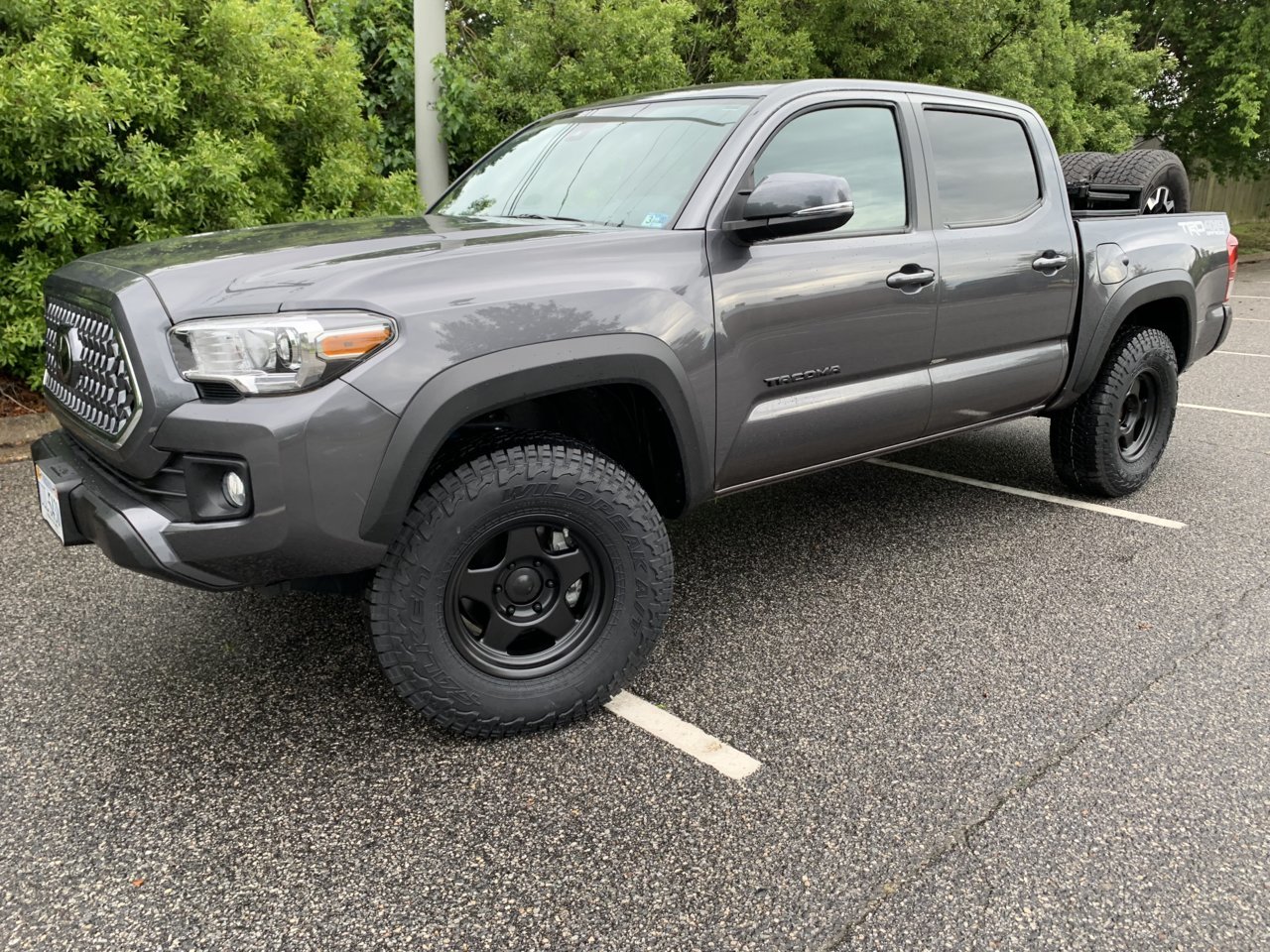

    Coop20
    Coop20 Member
    Jun 19, 2020
    #331952
    18
    2019 TRDOR MT
    I started out with 265/75/16 on F5s 0 offset with no issuesF5s no lift.jpg
