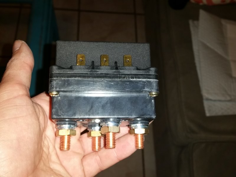

    What are you guys using as aftermarket solenoids?
    I have a solenoid that screwed up after getting water and mud into it.
    The winch works well, I have confirmed with a control box I used from a buddy that has the same winch as I do.
    All the aftermarket solenoids I have come across don't have anything for wiring diagrams, nor I have a way to know how to wire the winch remote to the solenoid and the wiring to between the solenoid and winch.
    Advice?
    What did you do?
    I can wire, solder, crimp, etc.
    I just need good wiring diagram I can understand for the remote control jack and the solenoid.
    Winch - Smittybilt X20

    I picked up a solenoid. I have NO idea how to wire it.
    I would like to setup in cab winch controls.
    No wiring diagram included in package.

    Kinda hard to do this from 1000 plus miles away .
    Just what solenoid did you buy??
    What does it need to do ??
    I would hope the coils are 12VDC rated for intermittent or continuous duty ??
    How many Amps is it rated for ?
    I would hate to see you burn up your winch or truck maybe the garage
    I can`t figure how one would even attempt to move the winch controls in the cab without being able to use a Multi Meter
    Best of luck

    do you have the gen1 or gen2 which? That solenoid looks like thet exact one the gen1 uses.

    I want to put in my own switches, in/out momentary and master on/off
    has anyone done this using this solenoid?

    plus, I don't have much room to mount the box.
    So I'm mounting the solenoid by itself.
    and running wiring into cab switches.

    a google search led me to this..
    hmm..

    1450633d1410403955-winch-solenoid-replac_a7fe47b3cb1223603d3f7d166cf54605470e87bd.jpg
    Looks like pretty much all solenoids are the same. Using this it shouldn't be too hard to do.

    Awesome. now that i know what each connector spade is, i need to find out the wiring on some OTTRATW switches.
