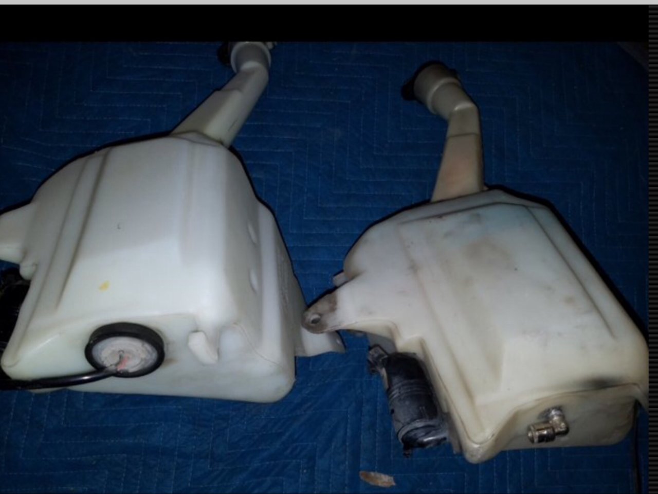

    Just got my aftermarket one from my previous posts.
    Not sure of the material but it says HDPE and has a 2 in the recycling symbol. Feels like a thicker milk carton.
    The stock strainer does fit. Cap is able to close over it.
    Using RTV grey on all the grommets. Washer fluid pump seems tight enough to be water tight, however the low fluid sensor was too loose - so both mating surfaces get RTV there. Tried to use the stock grommet, but it was too tight and the sensor wanted to pop out, that wasn't going to work. Letting that cure before I put the filler neck in. Both surfaces will get RTV there too. Not taking any chances.
    Done. Going to fill up and check for leaks tomorrow, then reinstall the black shield thing.
