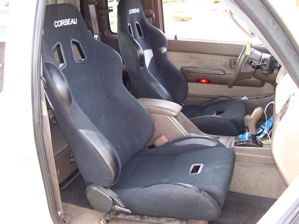

    Corbeau seat rails. Part # E2102T and E2103T. $105 each. Then choose the seats to your liking. I would verify compatibility between the rails and different brand seats if you don't want corbeau.

    Corbeau seats and brackets
    Straight bolt in because I had the brackets. They adjust Forward and back and up and down. So comforming to your body, I love it! Im using stock seat belt but the seats hold you in so well you don't even need those haha.

    Oh and I got use to the "harder get in" very fast (mainly because my side pad is wore down. But another problem is the seat sits lower so the seat belt is high across. I have the belt part on the lowest setting and its still close to my neck. And im 5' 8". Not a big problem though. just a heads up.
