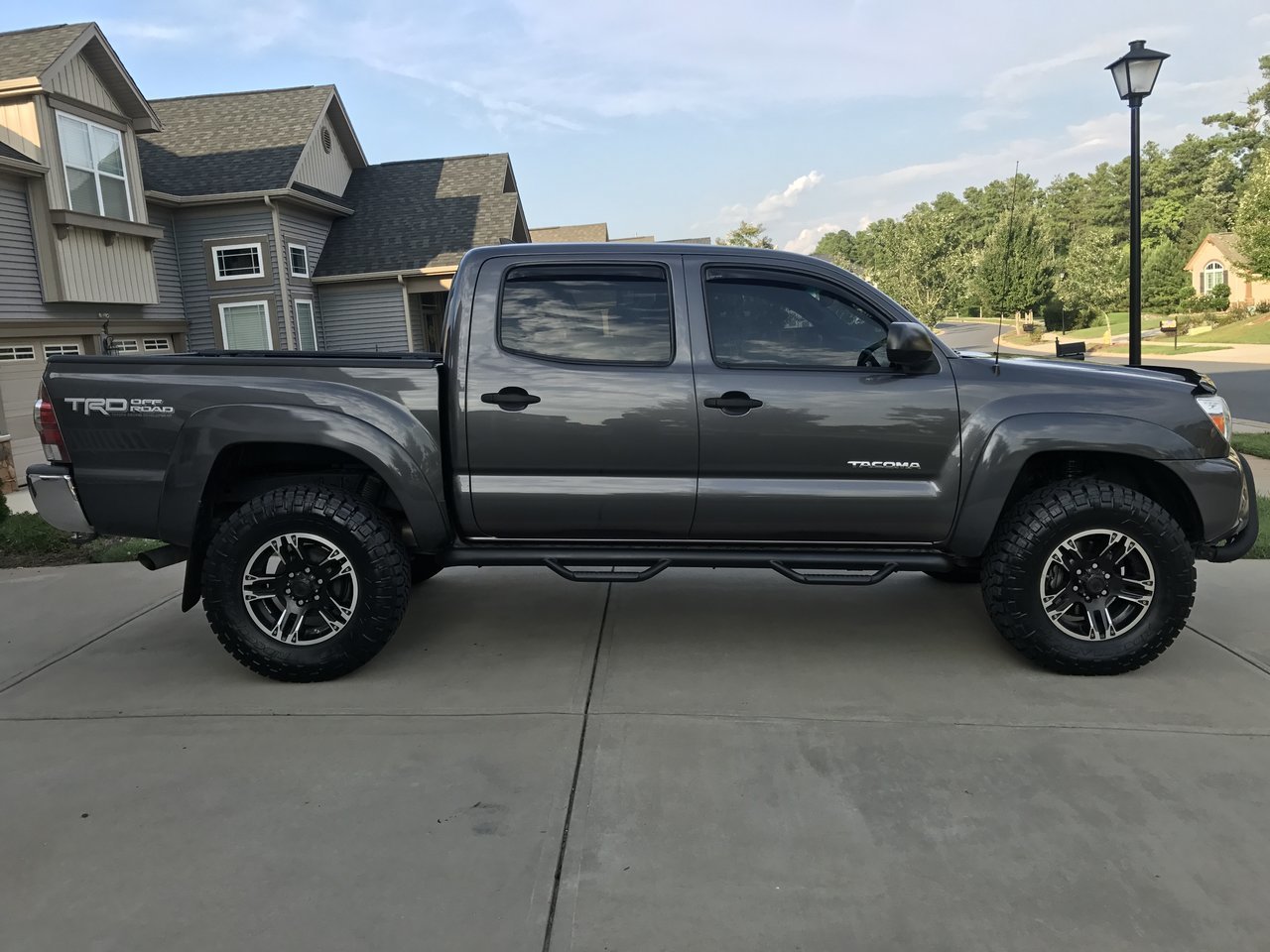

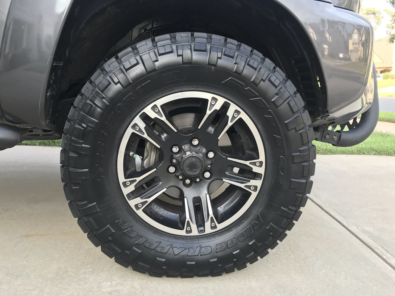

    285/70 r17 nitto ridge grapplers with a 1.75" bilstein lift in front and 1" block in rear. Very quiet on pavement. Handles better than my OEM. Nitto offered this in a C rated tire which made the decision for me over the KO2's that only had an E rated in this size.
