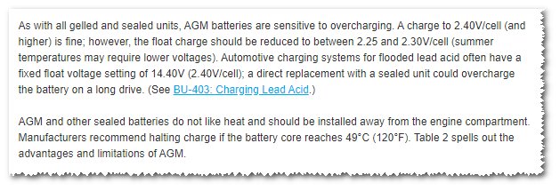

    Nothing, but I’d rather you tell me what’s good or bad about an AGM battery. That’d be more useful.

    Good feedback. Thanks for that. I was also thinking the same thing: selling a battery to the masses that may be problematic. Costco sells one, and you know how play-it-safe they are with their name.
    Looks like I got my heat answer - sort of. No real comment on one being more tolerant than the other. 120° in the engine compartment is probably a reality more often than not in AZ.
    @E.J. posted earlier that our alternator output is 13.9V and this article seems to indicate 14.4V might be too high in my climate. 13.9V would be 2.32V/cell which is a tick above their guidance. So maybe it's all good?
    Thanks for all the help on this. Glad we avoided full dumpster fire here.
