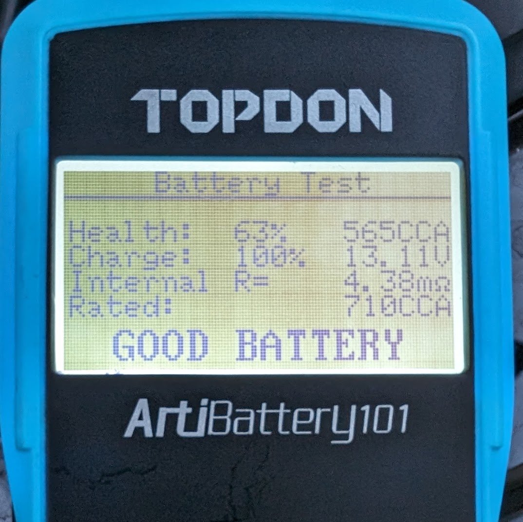

    Hi all. I just bought and installed a 24F AGM Interstate Battery from Costco in my 2022 Tacoma (stats below).
    I tested it with a Topdon ArtiBattery101 Battery Tester right after I installed it and got these results:
    Health: 63% - 565CCA
    Charge: 100% - 13.11V
    Internal R= 4.38
    Rated: 710CCA
    Now I know the 3rd Gen alternator can't charge it at the 14v it needs without a tune, but should the health and CCA be so low on a new battery?
    Any help here would be great. Thanks!
    Battery stats:
    Item Number: 1624803
    Group Size: 24F AGM
    CCA: 710
    CA: 885
    Voltage: 12
    RC: 120
    Ah: 70
    Termination Code: TOP
    Wet/Dry: D

    If it’s not fully charged the CCA literally cannot reach its rated capacity. Without a tune I’d recommend a plug-in charger equipped to do a maintainence charge for agm and retest when it’s FULLY charged.

    Gotcha! So if I understand you correctly, the Battery Health is based on that lower CCA which is why it's 63%. Thanks so much!

    the cca are too low, you will need too put on an agm charger periodically

    Get a Noco Boost GB40 to keep it fully topped off.
    I'm running an Everstart 24F AGM from Wally World (Johnson Controls, same manufacture as Costco's AGM), but it has a 4 year free replacement warranty instead of Costco's 3 year. I charge mine about once a month if I remember. Still using the stock factory tune.

    As previously mentioned get a noco or etec battery maintainer. Batteries need 3 stage charge (bulk, absorption, float) for optimum health and to prolong their life. All good solar charge controllers go through these 3 stages.

    Thanks! I did just add two 45w Cascadia 4x4 solar panels and their Mppt controller. Do you think that will suffice?
