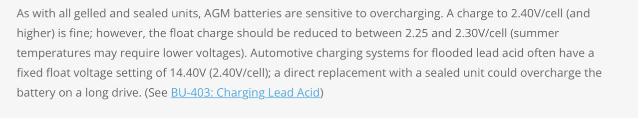

    Anyways…….I don’t have the thumbs to type out all I have to say, but if anyone ever wants to educate themselves, with free online information that is accurate, this online resource is a great tool. Not hard to understand, and well laid out, if you are a person who likes the deep dive:
    https://batteryuniversity.com/

    Just because you were ignorant to the requirements of AGM vs Flooded and never had a problem doesn't mean you weren't compromising some performance and long term health by using them on a charging system designed for flooded lead acid batteries.
