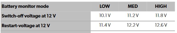

    I just put an AGM 27F into the truck last night. My rad support is on borrowed time now :D (I might relocate it). I have 8AWG going to a fridge. A random internet calculator says my voltage drop at 12.6V is 0.03V, so relatively negligible. And that's using 20ft, I think I'm closer to 10.
    https://www.calculator.net/voltage-...ceunit=feet&amperes=0.9&x=Calculate&ctype=nec
    Point I'm asking about: What should I set the battery monitor to on my Dometic fridge?
    I am thinking I need to set it to high. Right now it's on medium (from my lead acid I had in the truck until last night :D)
    I am using a 100W solar and MPPT controller, so I am getting to the right voltage instead of the stock ECU tune on the alternator. But still, with the AGM I don't want to drive it too low on voltage.
    It appears, from another random website, 11.8V is about 30% on an AGM.
    https://shopsolarkits.com/blogs/learning-center/agm-battery-voltage-chart

    Kent, WA
    2011 Silver Tacoma TRD Offroad, 2022 Honda CB500X
    Icon Coil Overs. Deaver U402 Stage 3 Leafs w/ Bilstein 5160s. ARB Deluxe Bull Bar. Fuel Boost wheels w/ Wrangler Duratracs. Brute Force Fab Sliders & HC Rear Bumper w/swingout
    I'd set it to high for the safety factor. That's how I always ran mine, even when running off my dual house batteries (isolated from my starting battery). That way if the fridge did turn off, I could make the decision to turn it down to medium, or start my truck up and charge the batteries.
