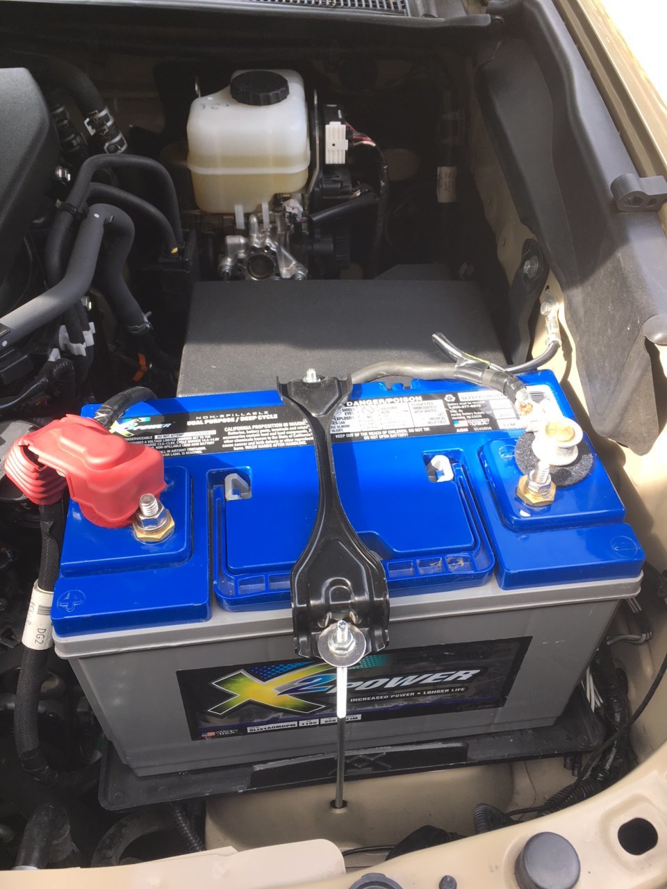

    I’ve had a AGM battery in my truck for almost 4 years now and every month or so it put in on a charger but it’s not really necessary as it’s really a matter of if you don’t charge it to 14.4 volts it won’t last as long. Besides a friend gave me the battery. Also, I’m too cheap to pay for a tune that will bump the charge voltage a bit.
