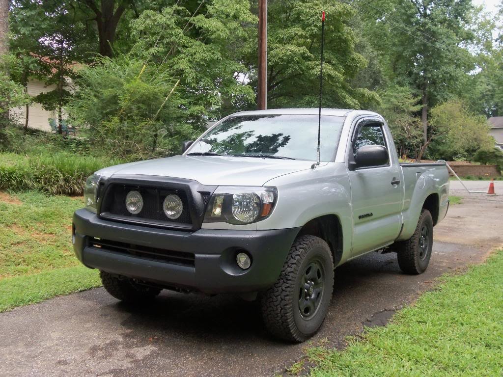

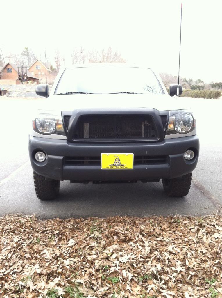

    Hey Everyone I have a 2009 5-Lug 2WD Base Model. I have done a few mods to my truck, but I am kind of limited to a small budget because I'm trying to make it through college:D.
    Mods to date:
    -Fat Bob's Garage Leveling kit
    -30x9.5xR15 BFG All-Terrains
    -DIY Satoshi Grill
    -Hella 500 driving lights
    -BHLM
    -Black Stock wheels
    -Reclining Bench Seat Mod
    -Black Badges
    -Removed Secondary Filter & Intake Resonator
    -Hard Wired GPS
    -DIY Skid Plate
    -Rear Differential Breather Mod
    -Sylvania 894 reverse light mod

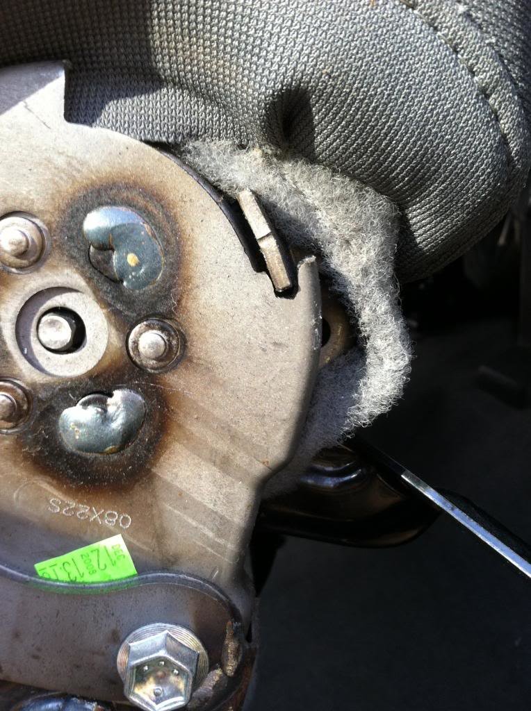

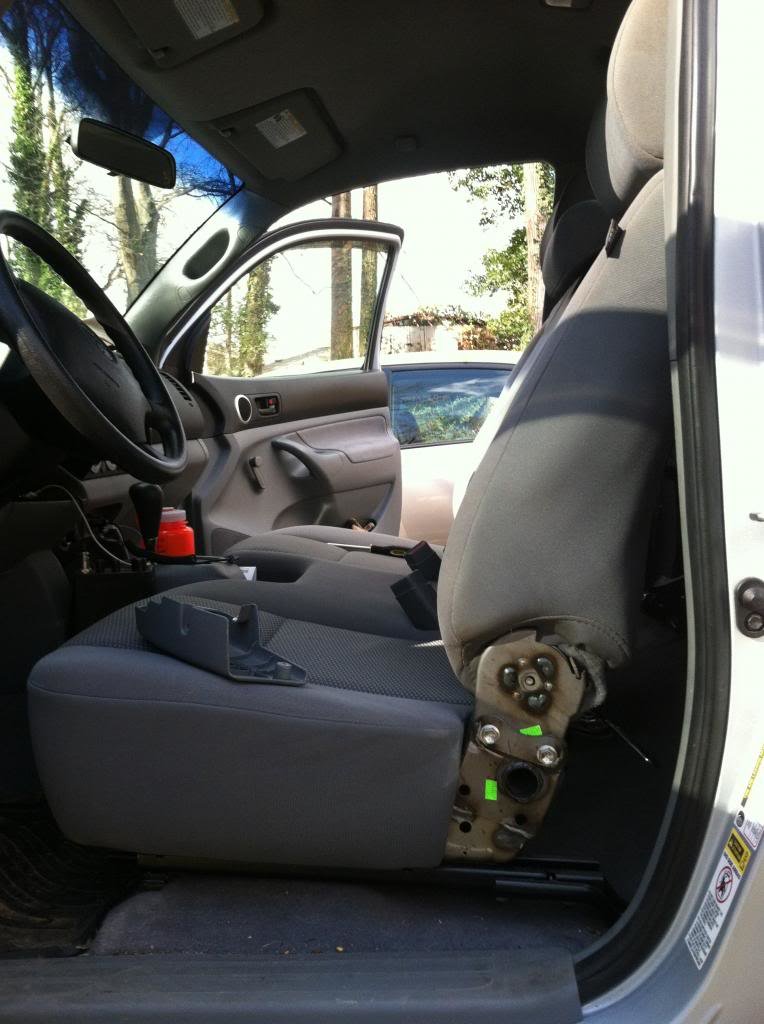

    I did the Reclining Bench seat mod the other day, and it turned out great. I was sick and tired of driving around sitting at a 90 degree angle. After searching around for a while I found a solution. Now I have 4 different reclining positions.:cool:

    Took my lights off to do some rewiring and put in an oem switch. My truck looks naked:eek:

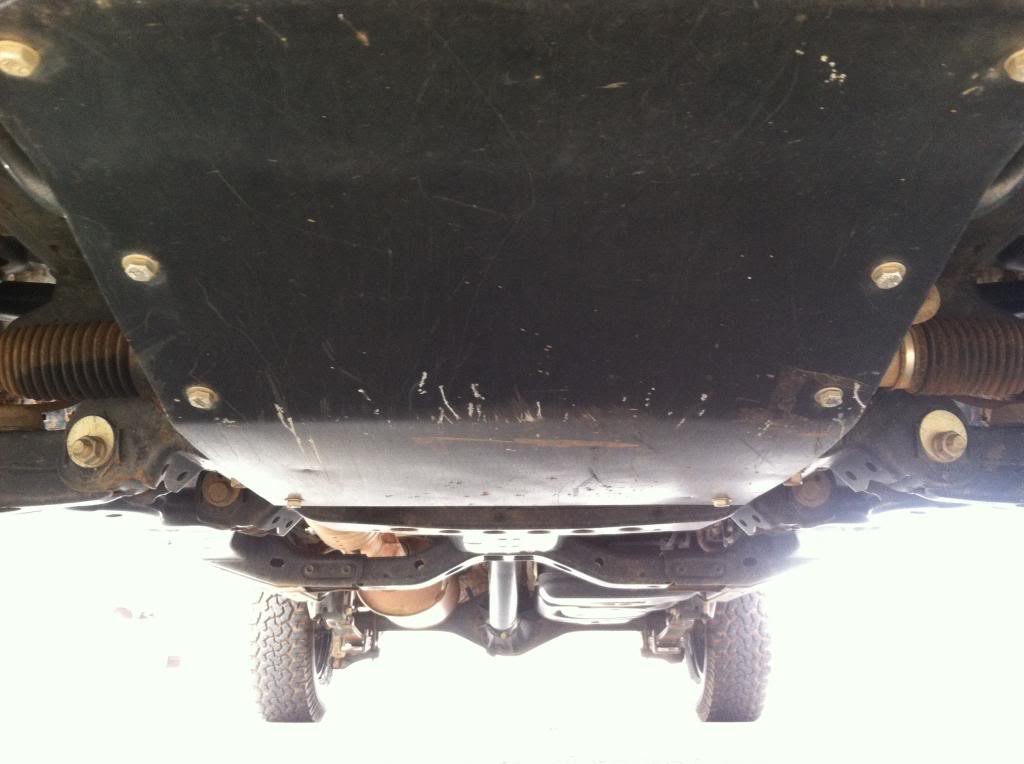

    Here's my skid plate I made out of an old stop sign I had laying around. Turned out pretty good, and it works for what I do.

    Hey brother how did you do this mod ? I'm dying to try it I can't stand it either after 4 years

    It's really easy to do. There are a couple write ups about it if you search around a little. Just take the screw out of the plastic cover on each side of the seat and pop them off. See how the metal tab on mine sits in that little notch. Basically all you have to do is cut the same size notch like you see in the picture above. Mine is about a 1/4 deep. Go slow and make sure the notch is the same on both sides of the seat. I used a dremel with a cutoff wheel. It took me like 5 minutes to do. I got 4 different reclining potions out of mine. It all depends on how deep you cut the notch. I wouldn't go too much further than what I did. You will be surprised how much the seat leans back with just that 1/4 in notch.
