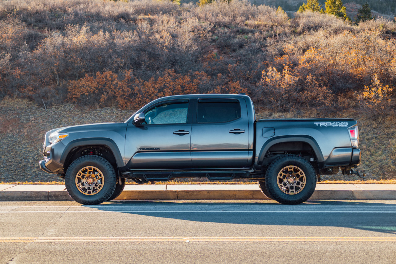

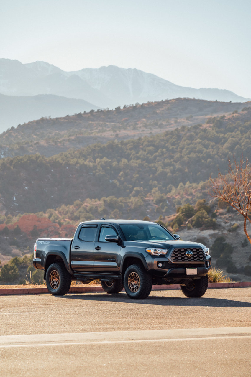

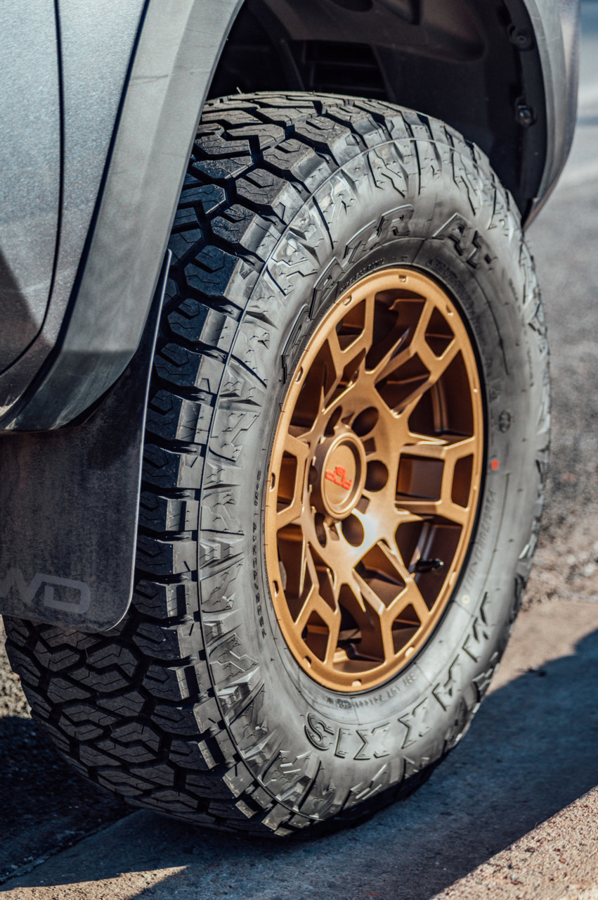

    Some more AGP goodness (also swapped to 285s).

    Thank you! 2" lift in the front, 2.5" in the back. No rubbing so far around town, but I'm sure it will on the trail. These wheels being +5 are helping for sure. Also, these Maxxis Razr ATs are on the smaller side of 285s. They're like 32.6".

    Looks like you didn’t need any spacers? Im running 2” or so Billy 6112 lift up front and icon RXTs in the back, prob around 2.5” back there or so.
    I figure I’m going to have to adjust my SPCs to avoid rubbing up front when on trails, which means I’m gonna have to get an alignment as well.
    I just want to make sure that’s all I’m going to need to do before I buy them.

    Nope, no spacers! Plenty of room to clear my UCAs and even the cab mount. We have real similar lift specs and the +5 offset on these seem to be the sweet spot. I haven't rubbed around town, but I'm sure I will on trails. Honestly, I don't really care about rubbing some plastic on trails like some guys do.
    I'd probably just get an alignment anyway if I were you.

    That bronze pops!
    Looks good man.

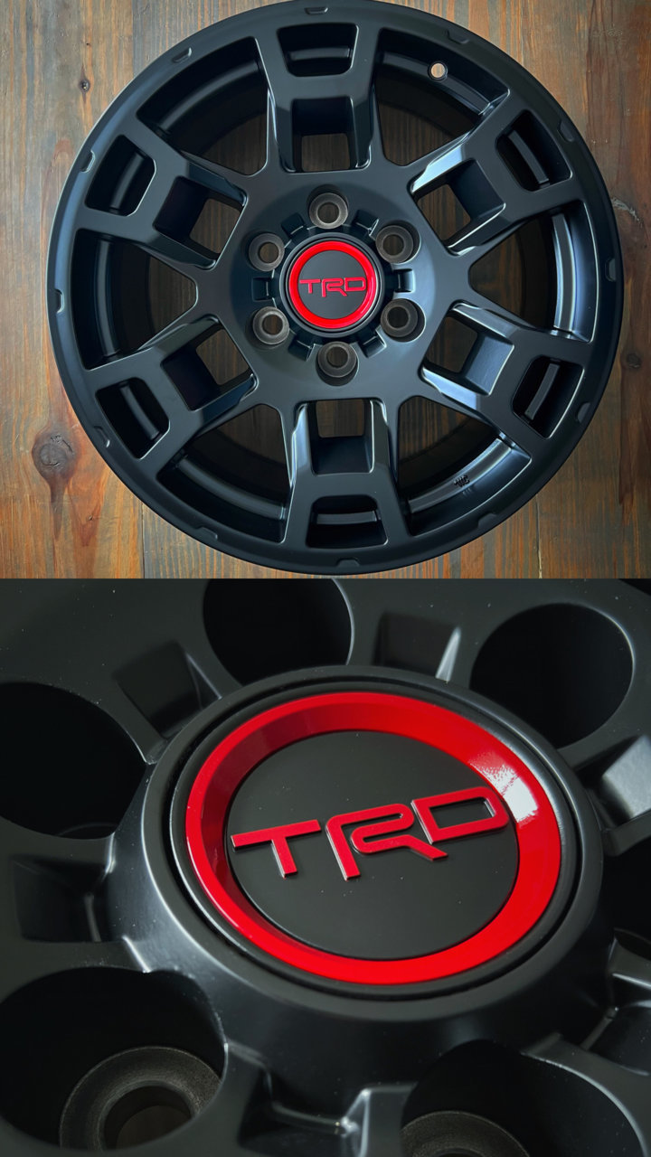

    Opted for AGP because I wanted the newer pro wheel with out having to have/shim the rears. Plus they were budget friendly.. $806 shipped or so to Texas.
    OEM caps do fit.
    *Haven't mounted them to my truck yet, looking for tires, and trying to do my suspension as well all at once.
