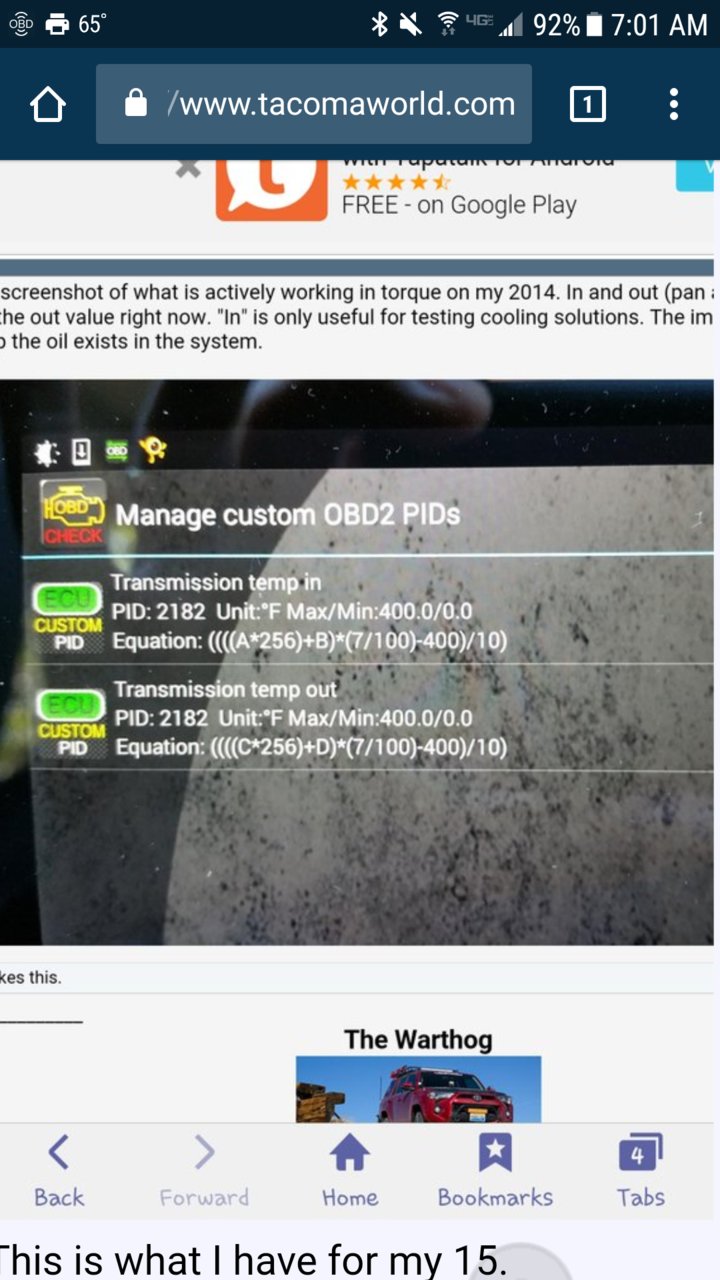

    What? I have Torque pro and it does not show this... how do you get the trans temp?
  10. Apr 13, 2018 at 4:14 PM
    Boyk1182
    Boyk1182 Well-Known Member
    Oct 15, 2017
    #233074
    4,765
    Northern Colorado
    On Scangauge it’s a code you have to program, 2 codes actually, it gives 2 temps. Torque converter and at the pan is my guess of the 2.

    I just added it to my torque pro

    I use the ultra gauge. There are several custom gauges, one of which shows a trans temp.
