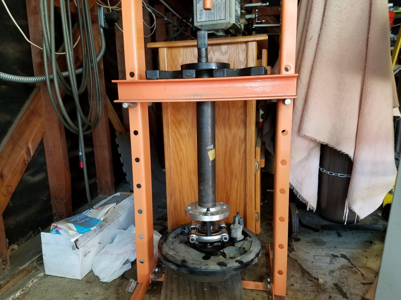

    So far so good. Purchased a bearing separator kit from HF. I let some Kroil soak for a while before pressing off the ABS wheel and retainer. Came off pretty smooth and pressed back on with plenty of tension. I think the drivers side is going to be fine. Hopefully the passenger side will go just as smooth.
    Most difficult step so far is getting the backing plate studs hammered out so the bearing separator will fit.
    Here's my kludged up fixture from McMaster-Carr parts.

    Here are the McMaster part #s
    This is the black steel flange 68095K125
    The pipe 4457K119
    And the aluminum flange 44705K234
    I also used this 45605K655 to press the bearing in place.
    If I were to purchase again I would go with 2 aluminum flanges and no steel flange. The whole assembly is fairly heavy.
