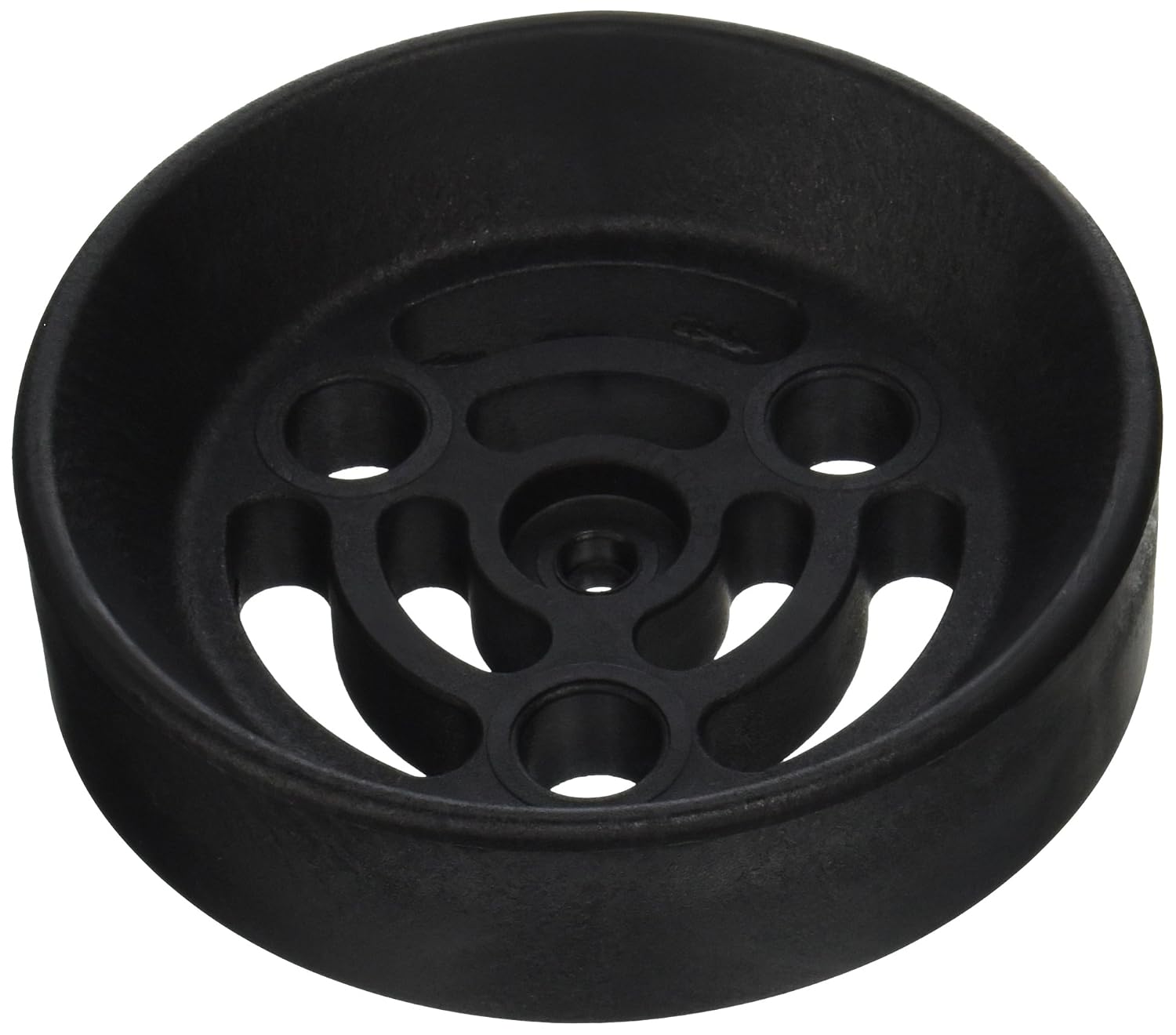

    Benefit of the daystar cradles? to stop pinching/leaking when running no pressure? just better than what comes with the firstone kit? or it just sits on the bracket?

    You still need to keep some pressure in them. The cradle allows you to run the bags without them bolted to the axle. Even stock suspension flexes down more than the air bags will allow. With the cradles, the bag lifts right off the axle when you flex an the cradle holds the bag in place when it comes back in contact with the axle - keeping it centered, more or less. My bags aren't perfectly centered in the cradles. I'm not worried. Even if one eventually chafes and pops, it won't be a catastrophe.

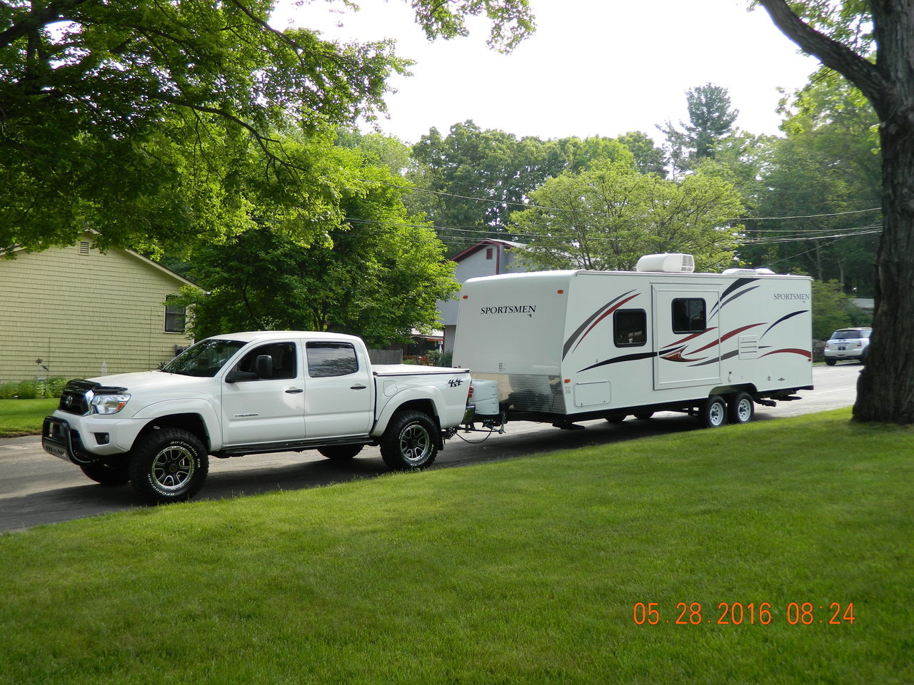

    It's a Sportzman KZ 242BHS - Dry weight is 4350lbs - total length is 26.5' - load weight with our equipment is 5500lbs +/- depending on how long we are camping for - Gross weight of the trailer is 6400lbs - I never tow the TT with any of the tanks full. Tow's like a dream, taking a trip 1st week of August to Bar Harbor Maine, for the week, about an 7 hour ride..a lot of hills too...can't wait.
