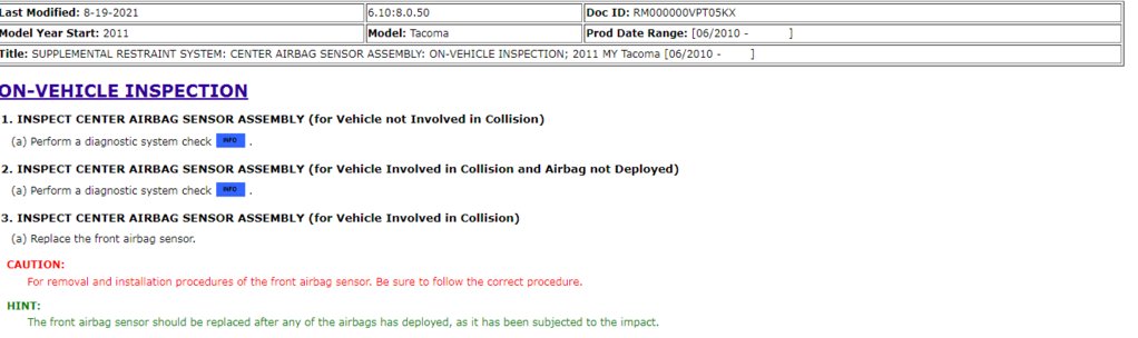

    From what I understand there was an airbag deployment at some point before the OP bought the truck, he sent the module out to be reset but that doesn't always work.
    It's typically reccomended to replace a SRS module whenever there is an airbag deployment as they are designed to lock themselves when there is a deployment, there are places that claim to be able to reset them but I'm not sure I would trust it.

    The VIN is not stored in the SRS on a 2nd gen, to my knowledge the only module on a 2nd gen that stores the VIN is the PCM.
    There isn't even any setup or configuration for the SRS other than zeroing the weight sensor in the passenger seat.
    It just says for vehicle involved in collision with airbag deployment replace SRS module.
