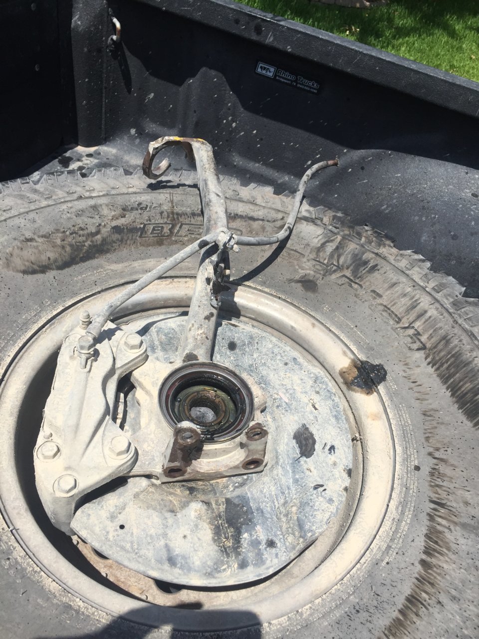

    It was a catastrophic knuckle failure that resulted in a accident. 277B8443-2B9D-4822-A00F-82474147DFA0.jpgIt ripped the tire/knuckle/spindle completely off. I will try to retrieve the code this afternoon.

    oh, well, if this bad, yeah, it could have triggered something in the SRS system.
    You said it resulted in accident. What kind of accident? Did you crash into something?

    My 19 yr old son was driving. Moving into center turn lane when it detached. Caused him to veer into a Mercedes which then clipped a Buick. Everyone is fine but his near mint 98 taco took a beating.

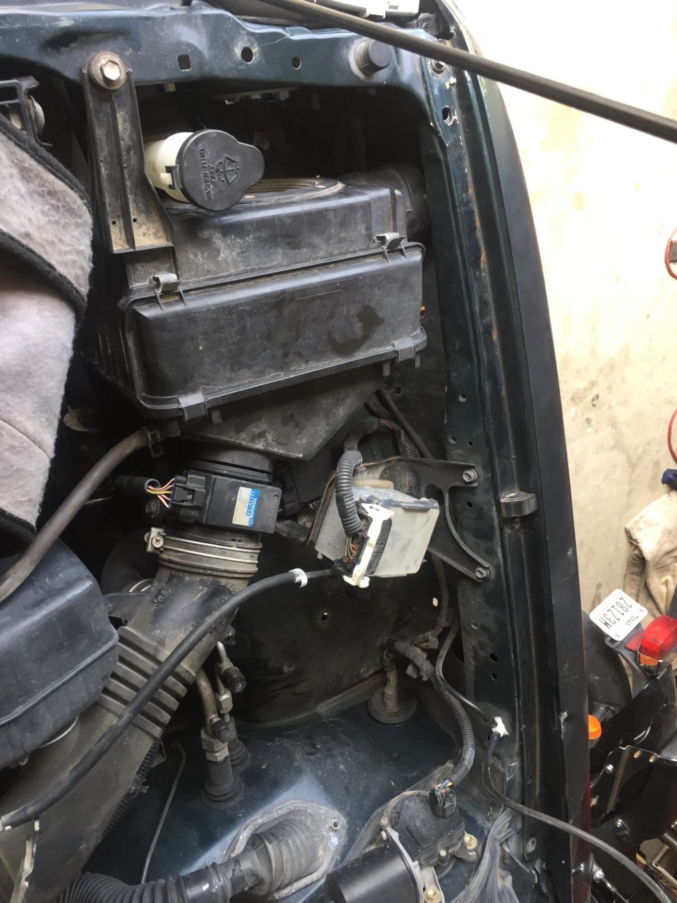

    I looked but can’t find the sensors. Are they on a 98?

    yes, there is on 98 trucks. Just follow the yellow wires. There is one hidden below the battery tray and the other one is in the same area but passenger side.
    the fact you say the light goes away when you turn off passenger airbag makes me doubt it is the crash sensors, as the light would always be on if you had a bad sensor
