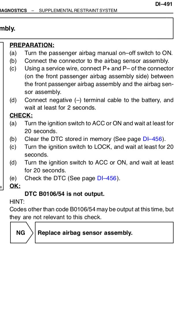

    one thing I found out on a Non Toyota that is (Benz) is that the system needs to be reset to clear the code just the same way the OBI has to be done but with a different controller to do so many body shop know or can tell you what or do it.

    no, I don't think so. I'm sure some shops can do it. Especially shops where they rebuild salvage title cars
    no, this is testing instructions for the SRS computer. When it says to clear the code from memory, it needs to be done with a special scan tool
    Oh and remember to disconnect battery and wait for a few minutes before working on the SRS system
