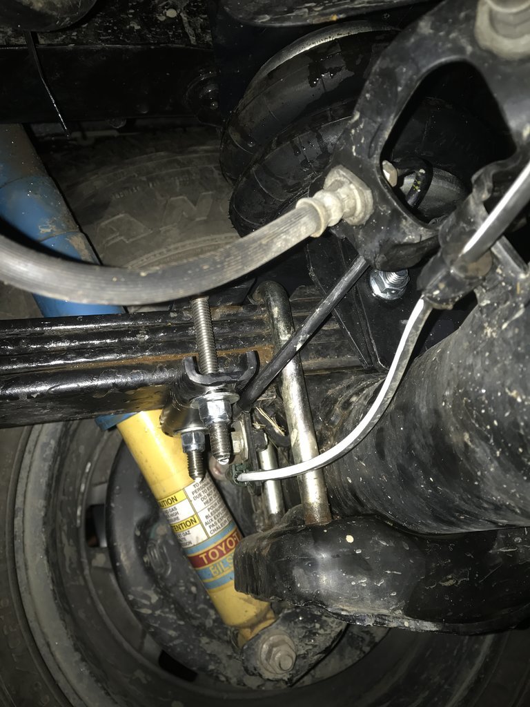

    I haven't seen anyone really complain about airbags yet...
    I got fire stone ride rites with daystar cradled to handle my RTT and camping load BC I am not looking to lift at this time. We loaded up and went out with the RTT (~200lbs all included) and probably another 200 pounds in the bed. With 10psi in the bags, the ride was so stiff that the slightest bumps or ruts would bounce my head of the back of the seat. I took the cradles off, which seemed to help a little, and made the lower mounts which clamp around the leaf spring as loose as possible, then ran the bags with no air. It is still very, very stiff. I believe the issue is the lower mounts which clamp the leaf pack together several inches away from the U bolt on both the front and back. Even making them as loose as possible I can still see the leaves become closer to each other. Has anyone else experienced this or have a solution outside of custom made lower brackets?

    Just a guess, but the air bag clamps may be preloading the overload springs. Usually, there is a gap between the ends of the overload springs and the leaf pack. Did that gap close (or get smaller)? If so, then that would make the ride a bit more harsh.

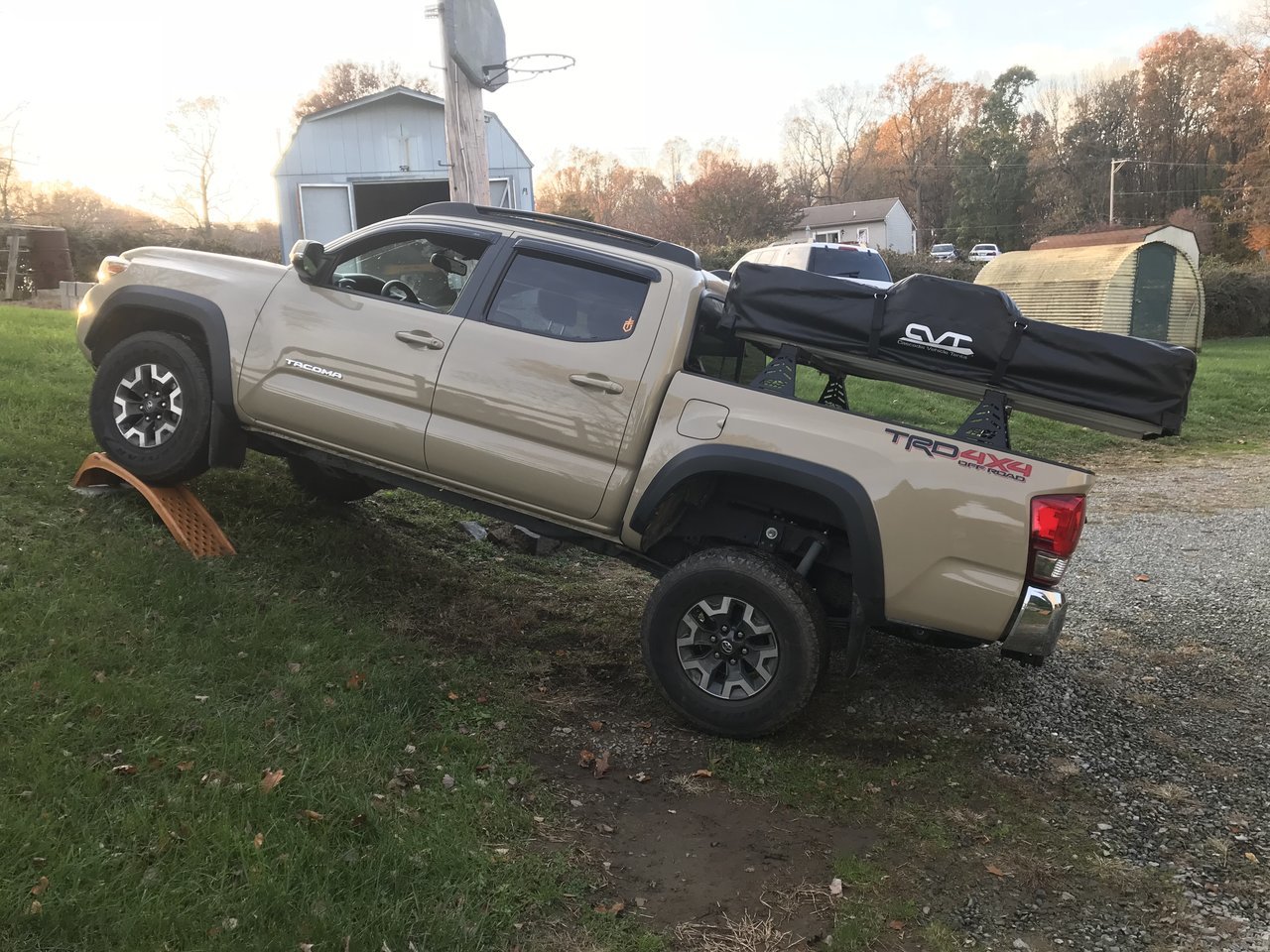

    Follow up...I got it all figured out. Turns out I overestimated the stock taco leaves and did not have near enough air in the bags (5psi) and was bottoming out a lot. I now keep 15psi in them and it’s good to go. I thought the issue was the way the lower brackets pull the leaf pack together-I tried mounting the lower brackets, with cradles, using monster zip ties around the axle housing and this did not change a thing. In a Hail Mary attempt, I tried putting a lot more air in the bags and it worked out. I also wound up ditching the cradles for the regular bolted mount. The cradles caused a loud slap after compression-rebound-compression, like the second bounce after going over a speed bump, and rebound felt kind of violent. I made a RTI ramp and found the cradles did not make a difference in articulation. Actually, I got 1/4” more ride height and articulation with the bolted lower mount, and rebound was not so abrupt.
