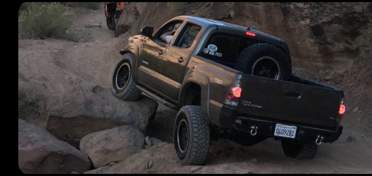

    I run them and even wheel Moab. Super flexy and no problems. Air them up when I tow and deflate when I wheel.

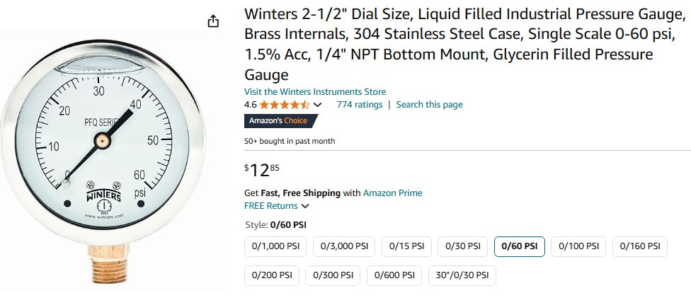

    Has anyone installed an inline pressure gauge that held up well? Looking for a sealed unit or alcohol filled unit that won't freeze up from internal moisture or crap out over rough roads. None of my compressor or bike pump needle gauges are up to the task. Wish to check at a glance on status. Had one side lose air and corrected, wye fitting both to one Schrader fill valve.

    What I use are 1” gauges with 1/8” NPT male ends. I bought them online from RAJ industries one with 100psi max scale(output side of regulator) and the other at 150(input side). They only read when I actually open the valve on my HP air bottle and slowly bleed down once I close it after setting bag pressure (possibly through the regulator). Butt dyno is plenty information for knowing if they need adjustment but I can hit the bags’ solenoid controls and that will allow the bags to charge the gauges if I’m in doubt. They’ve been installed since August of ‘18.

    thanks. Wondering how something like this holds up to bumps. I've had failures on my shop compressors and bike pumps numerous times. I think moisture gets into face or accumulates from air fill and suddenly the needle is frozen is near zero permanently.

    If it’s ice accumulation then I’d add a filter with a drain since ice would probably not be a good thing anyway. It’s usually included anytime water adversely affects performance. Compressing air concentrates water in these systems so it’s possibly failing from the inside out rather than from water leaking in through the face. Glycerin filled would certainly help with condensation though.
