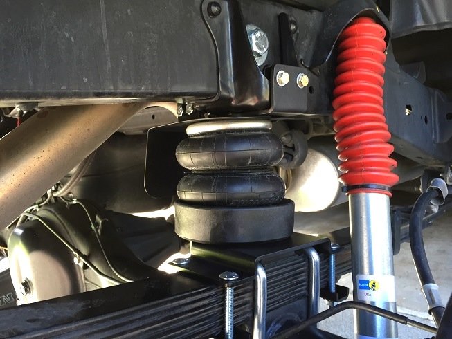

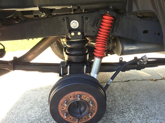

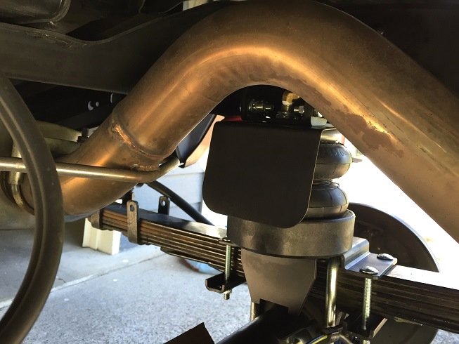

    I have been running the air bags and cradles for a little over a month now and wanted to post some feedback. The air bags are great but I didnt like how they worked with daystar cradles and my suspension setup. Every time I would hit a decent bump, both on/off the road it would launch my rear up and then make a loud "clack" when I came down. This was only with 5 psi in each side.
    I removed the cradles and now the truck is more controled when hitting bumps. Also the clacking noise from plate slap has gone away. I think I just dont have enough suspension lift for the cradles to work on my truck. When the cradles were on I was squeezing the bags just from the natural stance of the truck. This was causing preload on the air bag and giving me the "bouncy house" effect.
    With cradles removed I have about 1/16" between the air bag plate and the lower mount that goes on the leaf springs (unloaded). The cradle thickness is 3/4" so it was interfering with my up travel.
    The cradles will be hitting the For Sale section soon.
