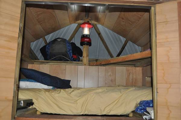

    Firestone airbags rock. 2 lines installed. I also tow the trailer in the background as well as the 800lb home built camper. BFGoodrich All Terrain TKO's complete the package.

    ^ that's bad ass. Any pictures of the inside camper?

    Second that on the pics of the inside. Thats cool looking.

    Just back from a backpacking trip. Camped at a state park then out for a night into the woods.
