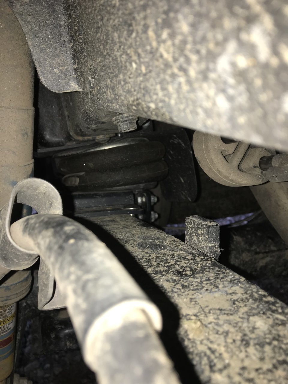

    I went with sumo springs. I actually just bought the foam spring itself and made a custom perch, so that I could make it exactly how I wanted with my AAL. However, they make spacers and were working to send me a spacer kit with their stock perch but for the money it was easier to just weld one up myself.

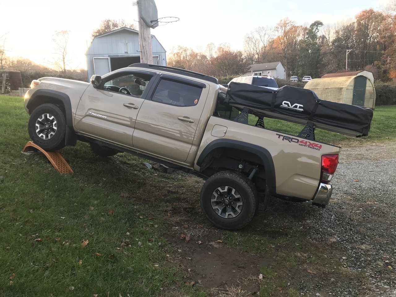

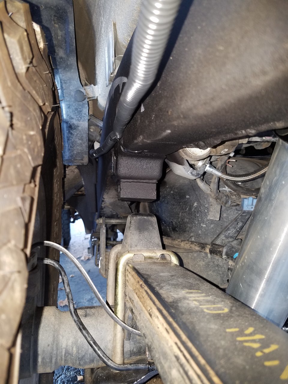

    Those foam bags look really interesting. Could I ask you a favor. Next time you have a big load of logs in your truck, jack up one side of the rear axle and take a picture of how the bag contacts the frame stop.
    Something like this. Here I used a tarp to fill the bed with water.

    I have a picture in the previous post. It's the one where my truck frame is covered with all the damn salt they throw on the roads here every time snow is even a remote possibility. I installed them so they sit off the frame about 1.5''. I find that with this, on normal roads they basically never contact and it's like they are not even there. Only with a big load do they contact, and the way they are designed they progressively load the foam springs so lighter loads are less stiff...obviously. I can vouch they help out tremendously with heavy loads. Feel much more in control, bed doesn't sag, truck doesn't roll as much.

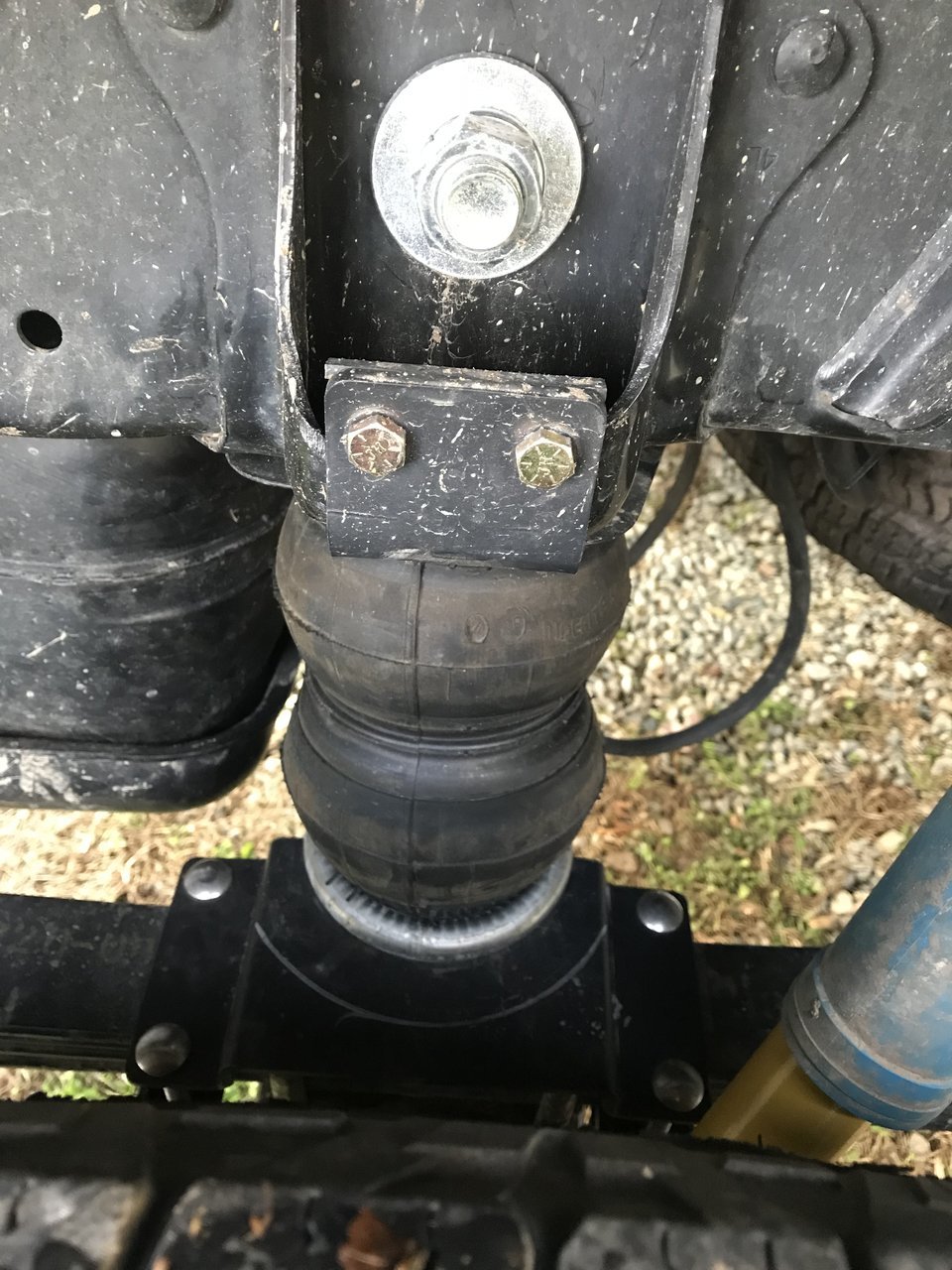

    I had AAL’s on my 2006 and currently have ride rites on my 2016. Airbags have not been so straightforward for me. My rear suspension is otherwise stock FYI. I have not had any problems with them- they don’t leak or anything, and a cheap bicycle pump fills them up no problem. On cradles; I initially got them from the start. I did some testing with an improvised RTI ramp and found they had no affect at all on droop, but they did cause the rebound of the rear end to be much less controlled, and since the bag sits down in the cradle, they could theoretically contact the frame. I left them off permanently. For me, the factory ride quality has not been achievable at lower psi. I initially tried 5psi and found that it caused the rear to bottom out very easily. The stock suspension setup contacted the bumpstops way more often than I first though. Some people say the bags have internal bumpstops but I have not seen anything from Firestone that says that, and it sure doesn’t feel like they do when it bottoms out. With my RTT on now (~210 lbs), it needs 12-15 psi to keep from bottoming out. This causes a harsher than stock ride since they effectively increase the spring rate. They did end up lifting the rear maybe 1.5”, and I have had 750lbs of shingles in the bed (+ the RTT) and it felt great.

    I e-mailed them all my dimensions just to be sure, and they were going to send me a "custom" kit. they only part that was custom was going to be a spacer to raise up the foam piece because my truck had an AAL.
    https://www.supersprings.com/shop/ssr-610-40/
    This is the part they were sending me. It is the one for the second gen. Really the bump stop/ U bolt configuration for the 1st and 2nd gens are the same. I am 99% sure you can just slap this on a 1st gen and it would work right out of the box.
    https://www.supersprings.com/shop/ssr-601-40/
    I just bought these bad boys and made the bracket myself. Was almost going to just drill a hole through the stop piece that contacts the stock bump stock on the bottom of the truck frame and just mount it there, and then take a sawzaw and cut the stock bump stop rubber flat.

    I was wondering how the spring lined up with frame stop when the rear suspension is articulated like in SDFM32 post. Probably not enough shift sideways to matter but would be interesting to see...no biggie.
    SOMDTACO[QUOTED] likes this.

    Full stuff

    That does not look bad at all. Not too much shear...thanks for taking the time :)
