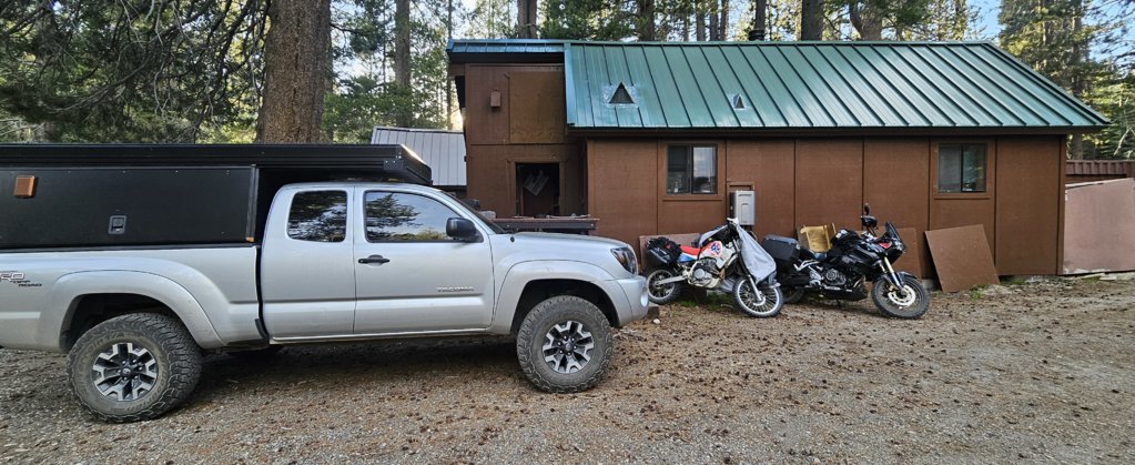

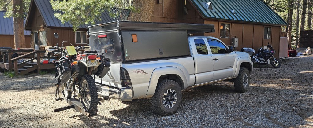

    I have an 06 tacoma with a 2.5in OME lift and a lone peak camper. When I have all my camping gear and bike on the back of the truck, it has a good sag but for my daily driver I keep all that stuff out. Is it OK to use air bags while driving through the desert or some medium off roading? I don't really want to put a beefed up rear on there if I don't have to since mostly running empty in the back except the camper. Here's a picture with just the bike and here's without

    You will hate the air bags when you aren't loaded up, and they can't make up for crappy leafs. A good set of leafs is the way to go, even if you do decide to add air bags later. The OEM (and OME if you have those) leafs suck, so any constant weight like your camper is well into the "have to" territory in terms of needing to beef things up. Look at Deaver or Archive. They will ride smoother than what you have now when empty, and easily handle the extra weight without sagging.
    Rear suspension is very much a "buy once, cry once" thing. Do not cheap out or you will regret it.
