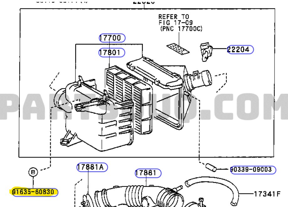

    Hello to all. I have searched here and online to no avail. I am looking for the bolt part numbers for a 2002 Tacoma double cab 3.4 L 4x4 air box. There are three bolts. They may all be different. My Tacoma came with a KandN and I am removing it and putting the stock one back in. The airbox assembly only came with one of the three bolts, and is missing the metal spacer on one. Wanna make sure when I go down to the Parts department I have the number. Thank you in advance for any help that you can give me. Take care

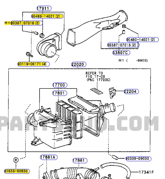

    Only one is called out in the catalog: 91635-60830. The others are kinda maybe just by proximity, cause I don't remember if the elbow has 4 bolts or not, so the maybe, is that those are the other two...
    90119-06171 (bolt), 90387-07016 (collar), 90480-14021 (grommet)
