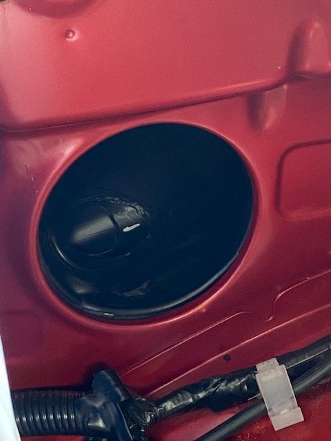

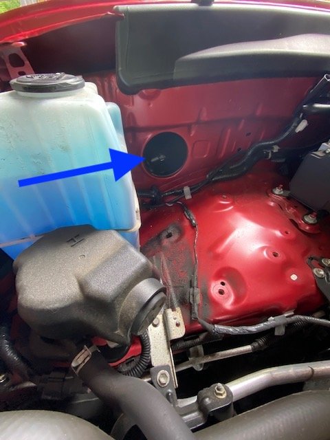

    Hello, in regards to a 2019 I4. I am trying to mouse proof the air box. I removed the box trying to find the air inlet. The air enters the box from the hole with the blue arrow. Does anyone know where that hole goes ? I am trying to find the origination of where the air enters to get to the air box so I can put a screen over it. Thank you for any help.

    I am not sure - but if you have a compressor - try blowing some air out of it and see if you can feel or hear it from outside the truck ?

    Why not just put a screen over that hole?
    The primary concern about rodents is their chewing on wires. Yes, they will chew on other plastic as well (e.g. my tractor's air intake) but it's much less harmful.

    Isn’t the other side of the hole under the front fender? Like back behind the tire and up?
    that’s my understanding of where the air comes in, unless you get a snorkel.

    Yeah. Behind the finder liner.

    In front of the right front tire, the fender line has slits. Remove the fender liner from there and you will see the other side.

    Everyone, thank you all for the great help/info. Im going to try removing the fender liner and see what I can do, thank you.
