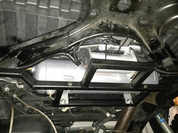

    Viair 100% Duty cycle mounted under the bed.
    airs up tires and will run an impact enough to get wheels off.
    2.5 gal tank
