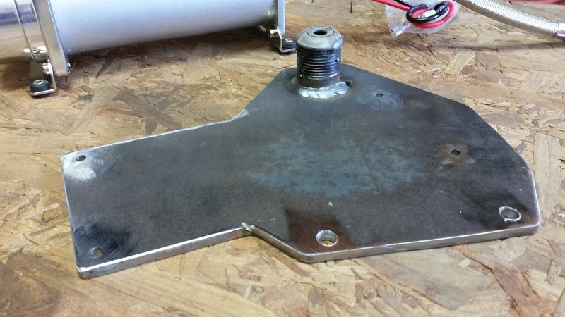

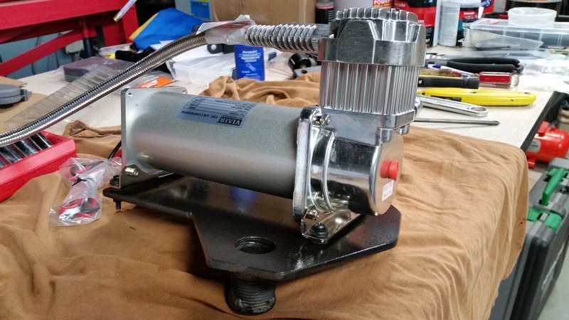

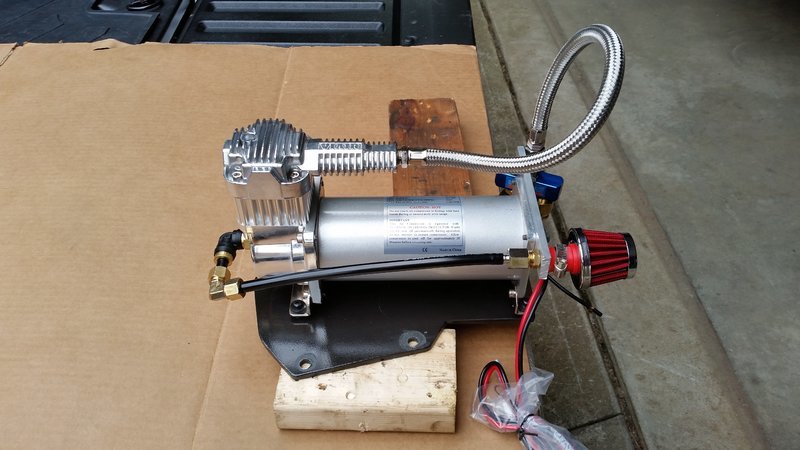

    Sorry I didn't do a step by step by step20160803_120422.jpg 20160804_072422.jpg 20160808_074146.jpg .What I did was make a simple 1/4 inch mounting plate to utilize the three studs on the
    pass. side fender well.I had already installed an 80 amp bussman aux relay box to tap into for power.My cost for compressor and bracket was $250.I had a couple hours getting the bracket correct.Maybe 6-8 hours altogether running wiring etc. The back leg on the bracket is 1 5/8 inch overall
