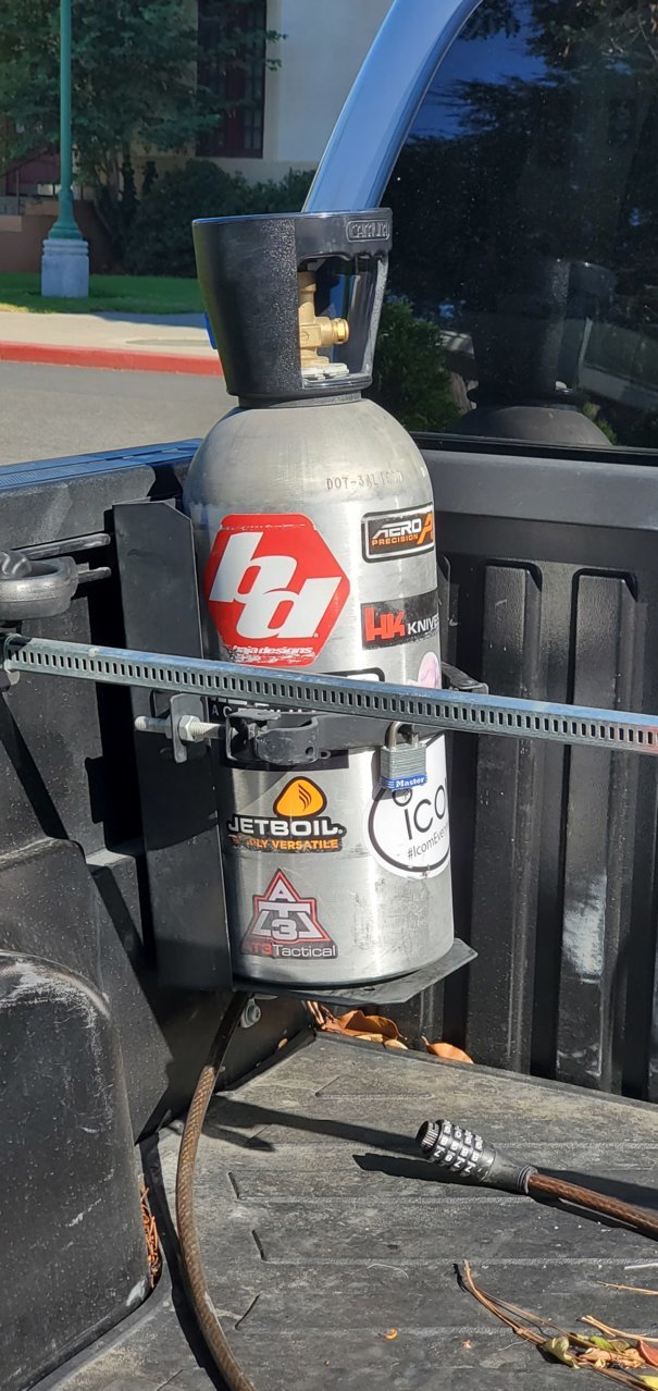

    I went Co2 bottle and will NEVER look back. Small footprint, inflates 33" tire from 12psi to 35psi in 22 seconds, no noise, no wiring. I get about 17, 4-tire fills on a $15 refill.
    EDIT: You can also resear a disbeaded tire on the ring with 1200psi of Co2, and no onboard or portable compressor makes the psi needed to accomplish that. It will run airtools as well, but not many need that option (I keep a Dewalt cordless impact onboard for wheel removal, but have never needed it beyond that).
    Only drawback is all of my buddies with compressors ask me to refill them instead of wait for their compressor at the end of the run.

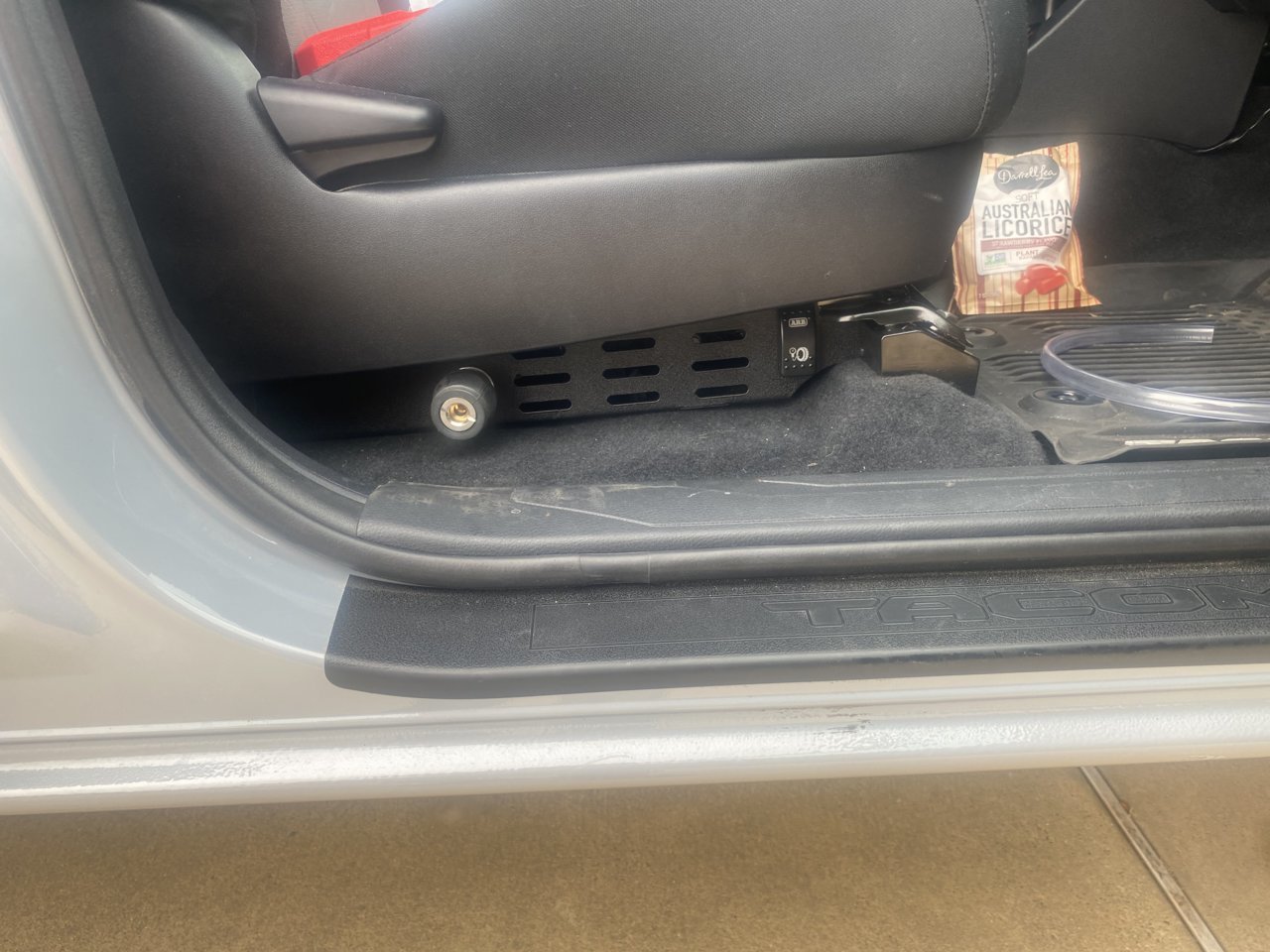

    Desert does it bracket. Arb single. I had already bought the seat jackers so… why not? It’s not that loud, the seat muffles it a touch. It’s a nice spot though.

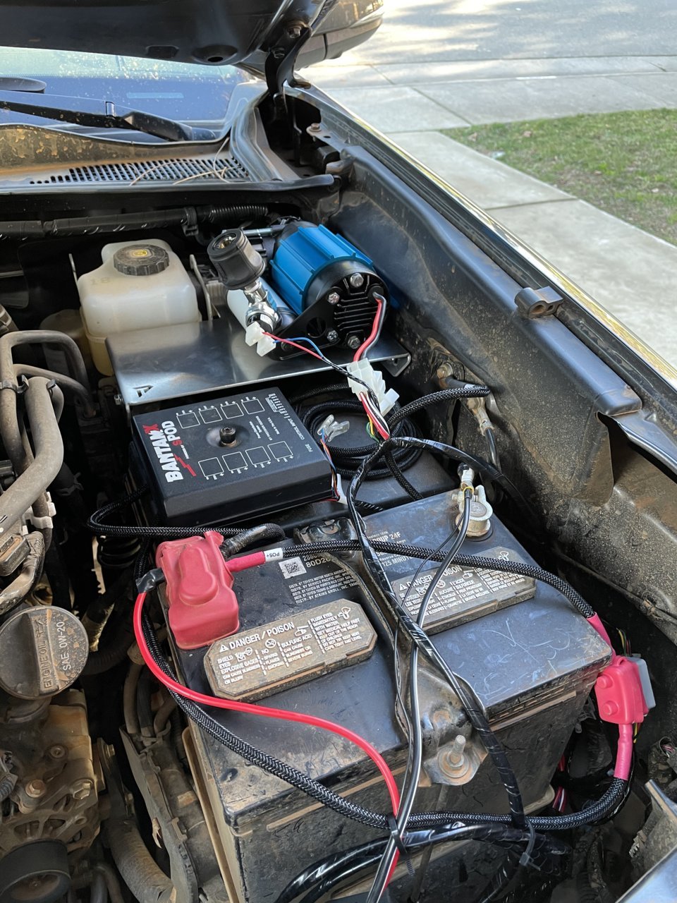

    It’s from Powertrays. I just got the blank and drilled holes where I needed. I have a quad-flate thingy and can air up all four 33” tires at once. Any bigger tires and I’d definitely go with the twin, but it’s fine with 33s

    I’d have to time it… I want to say maybe 10 minutes though? From 18-20ish to 32-34ish PSI. Usually just grab a drink and make fun of my friends bent over doing 1 tire at a time :cool:

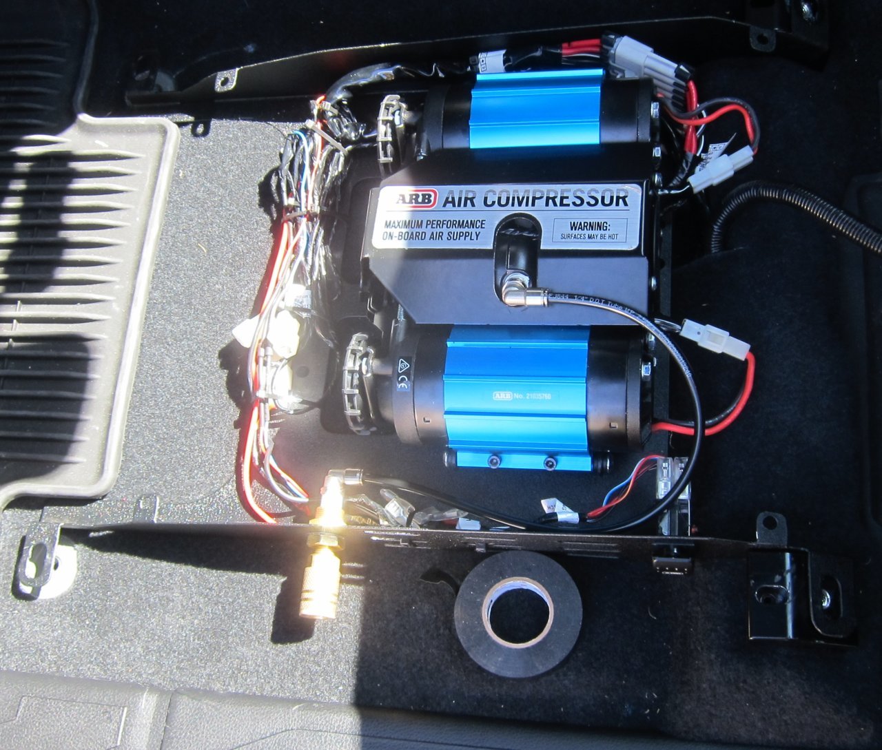

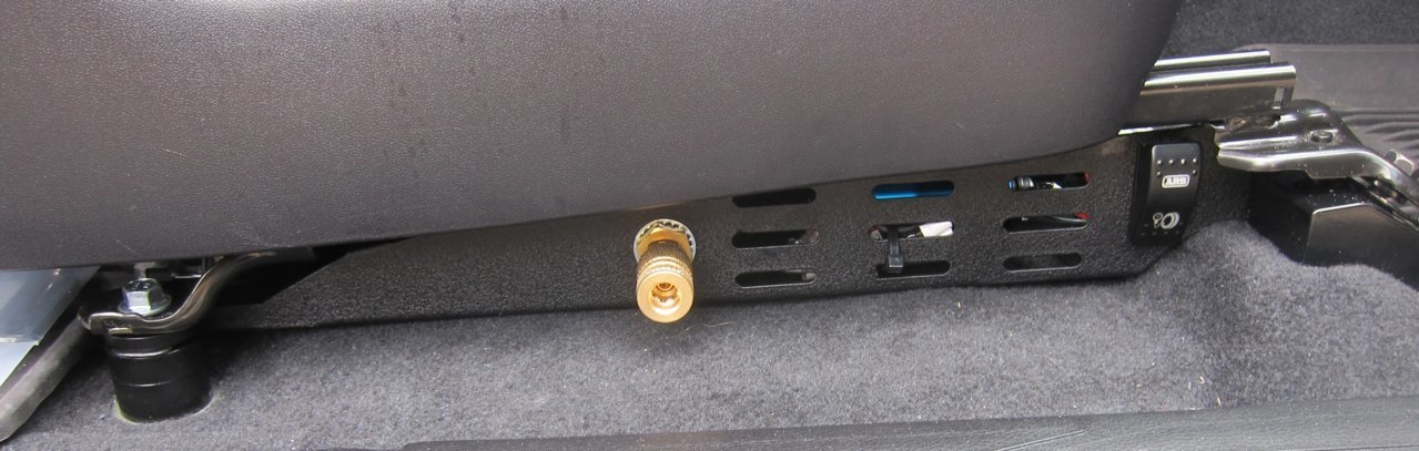

    I just installed a Twin ARB with the Desert Does It tray under my passenger seat. Yes you need both the front and rear seat jackers to install it. The hardest part was using the OEM firewall plug on the passenger side to run the wires as they come out back behind the glove box area and was a pit to fish out. IMG_5767.jpg IMG_5763.jpg
