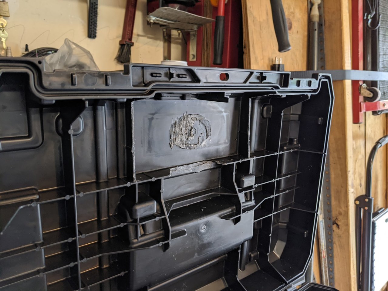

    I recently got the DeWalt boxes. They make loading for camping and other stuff a lot easier. I plan to mod one of them to better fit my Viair. I can get it in there nicely without trimming but cutting back a few of the ribs would make it a lot better.

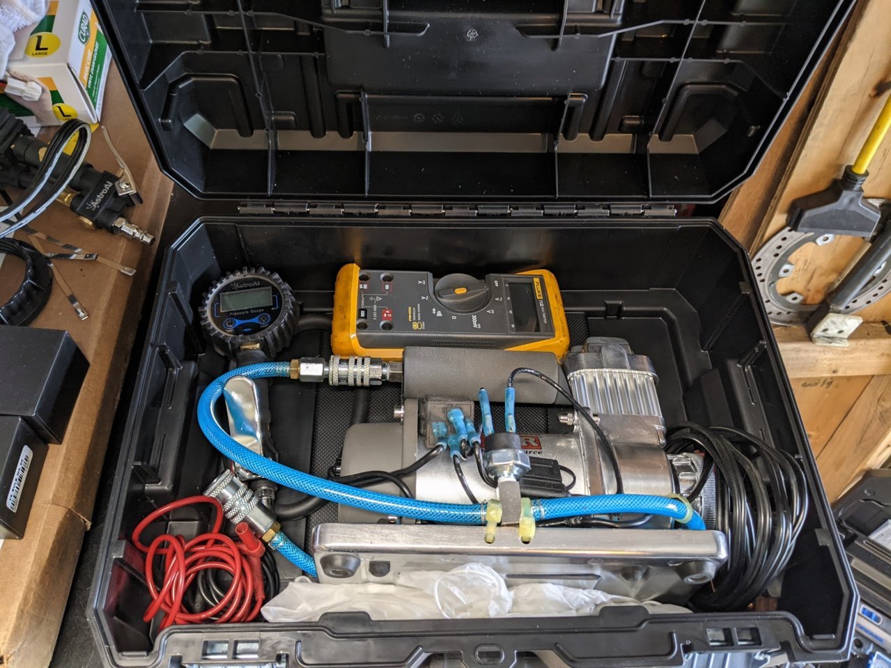

    Just in case this helps anyone, it was pretty easy to mod the DeWalt box for the compressor. Using some vinyl gloves (always handy) and my DMM to keep it in place as a kit:
