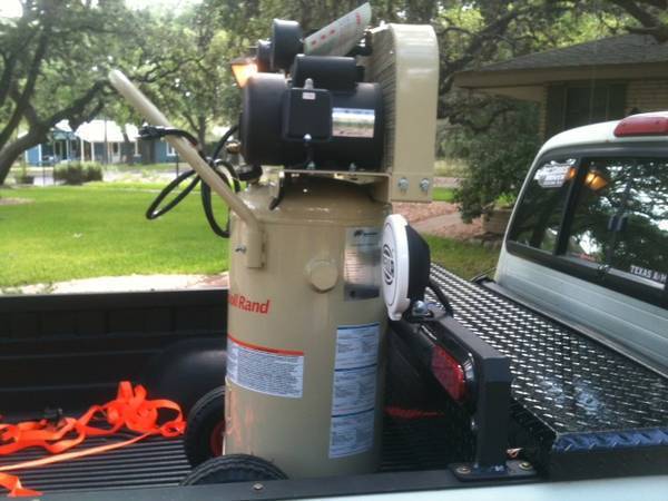

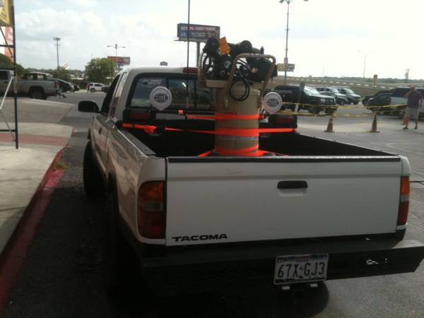

    I finally bought the compressor! A Ingersoll Rand Garage Mate thats about 2x more than what i need for my plasma cutter and i can run other tools on it as well.
    At northern tool all loaded up
    The first compressor i was looking at was at tractor supply and a ingersoll rand that was a 20 gallon and about 4x what i needed haha a little overkill. I was able to get the garage mate and accessories for just under the compressor itself at tractor supply.
