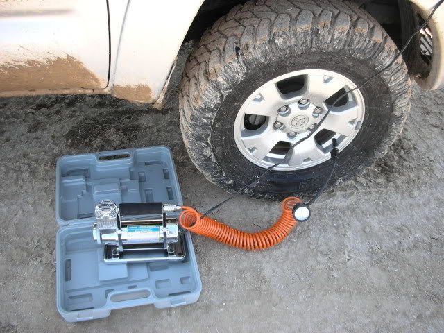

    MV-50 is great. Tons of guys run them. Some guys have even mounted them in the engine compartment. At $60 on Amazon.com, it's a no brainer. I actually originally bought a Viair 300P and returned it. The bag it came in had a bad zipper and the insulation on the wires was split open exposing the copper. :( Shouldn't have seen that on a $150 unit.
    Of course I also carry one of these as a backup ...
