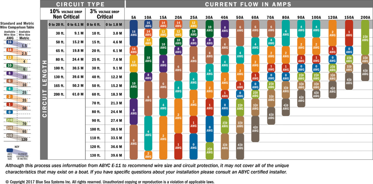

    I'd cut off the alligator clips and connect direcly to the battery, placing an in-line fuse as close to the battery as possible. I'm guessing they used 10 gauge wiring based on the maximum draw of 30 amps. To be safe, you can run 10 AWG or 8 AWG wire from the battery to the back of the bed cubby, use either a but splice or solder together. Be sure to use heat shrink. For a compressor, I would consider that non-critical and the voltage drop isn't that big of an issue.
