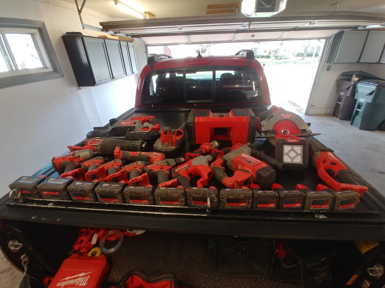

    https://www.homedepot.com/p/Milwauk...l_FBxpFpGvWKvmTCHnBoCD5YQAvD_BwE&gclsrc=aw.ds
    btw- love my 18v and 12v sets!

    Greed and glutony are sins. I can help you out though, I'd be happy to take half that pile off your hands :fingerscrossed:

    The sad thing is that that is an old picture, and I've acquired more stuff since then.
