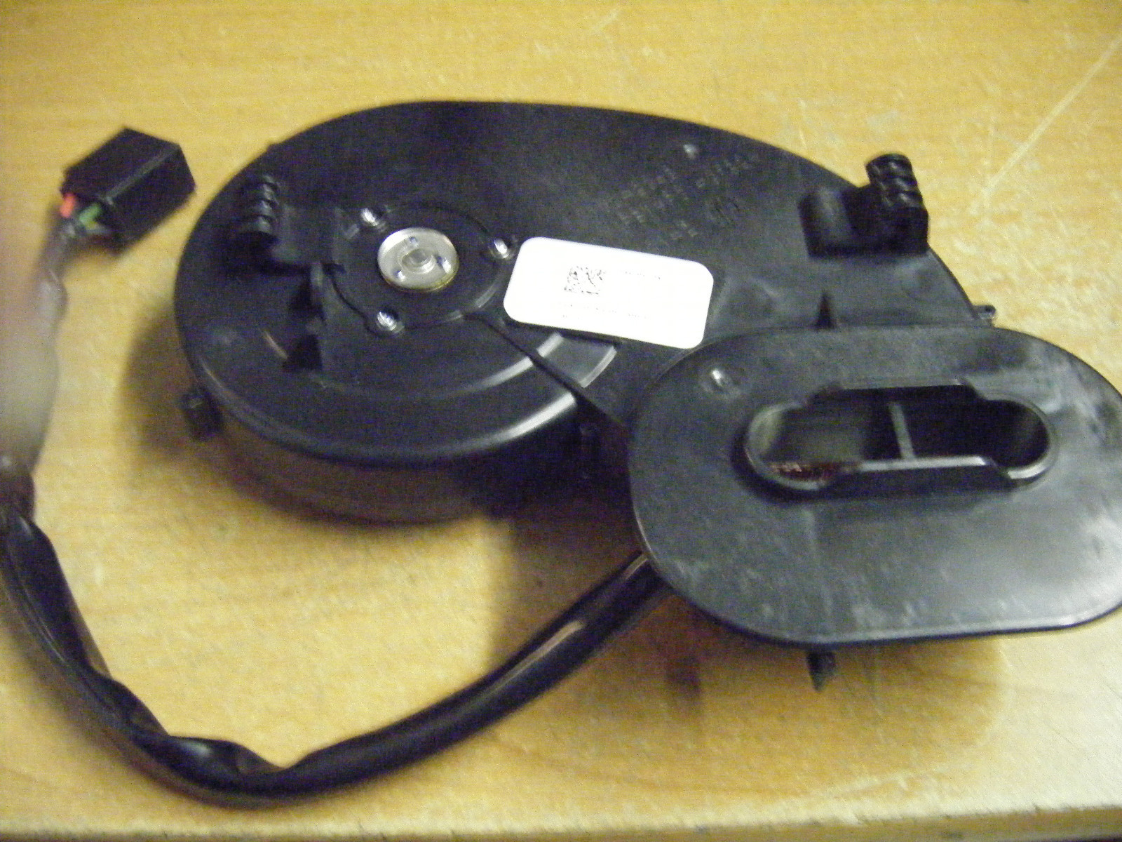

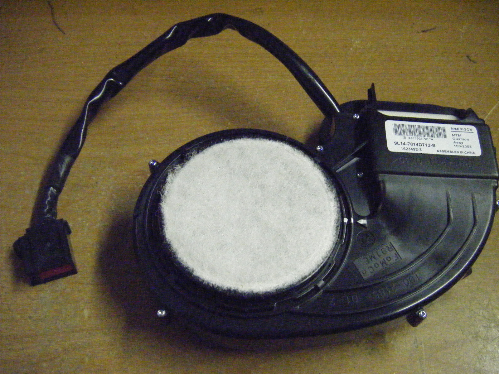

    This is how most cars do it... they have their own individual blower assemblies under each seat with piping throughout the cushion. Basically what I did in the OP, but with more dedicated air pressure
