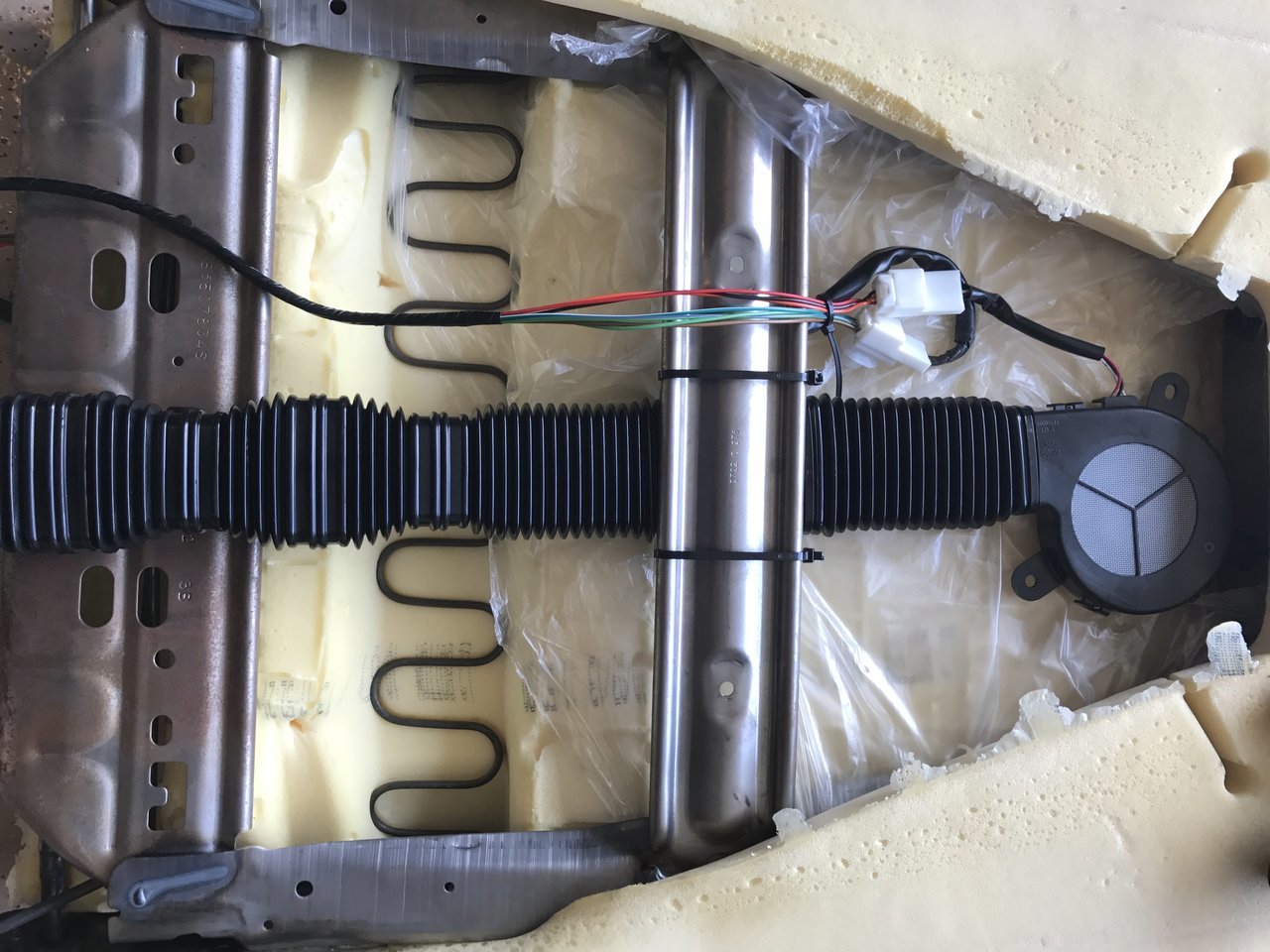

    Ok, check it out. @jhuey8947 posted pics in the Katzkin thread showing the fan is about 2/3 the way up the seat back, then pipes it down from there.
    So shouldn't I be able to route the air from under the seat up to that fan, which will then pipe it through the seat?

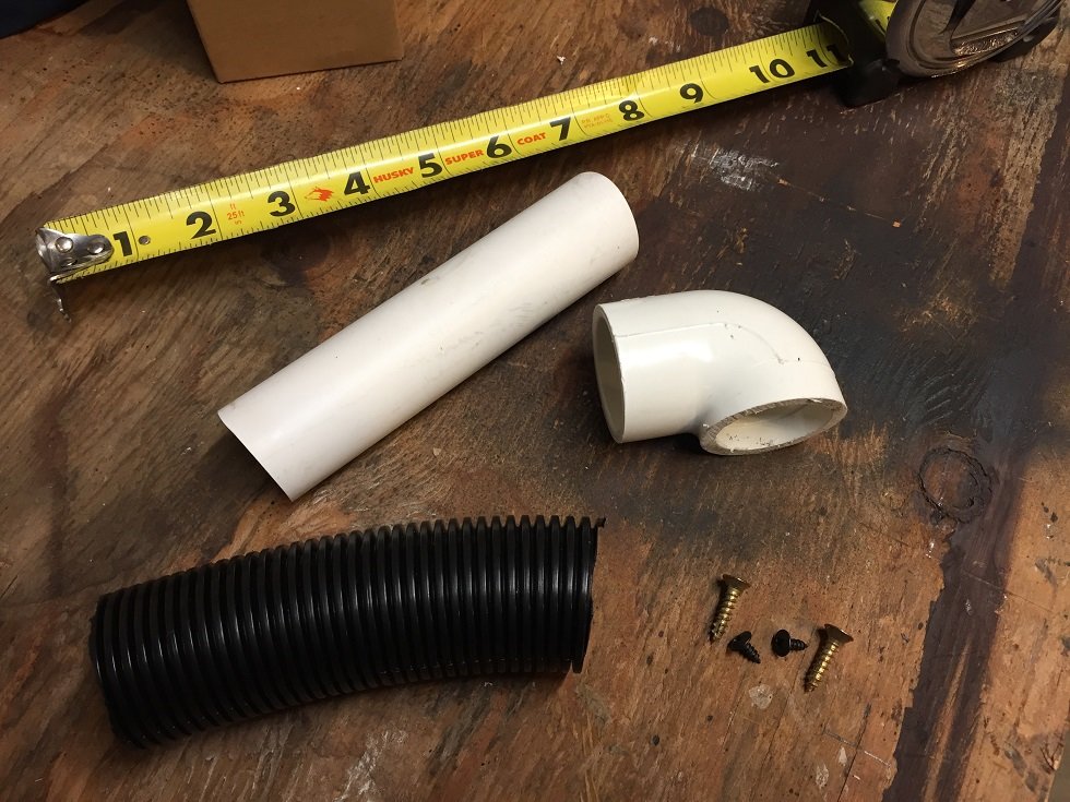

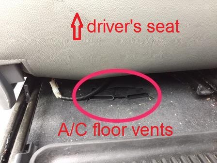

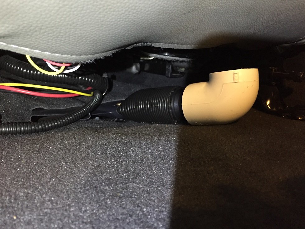

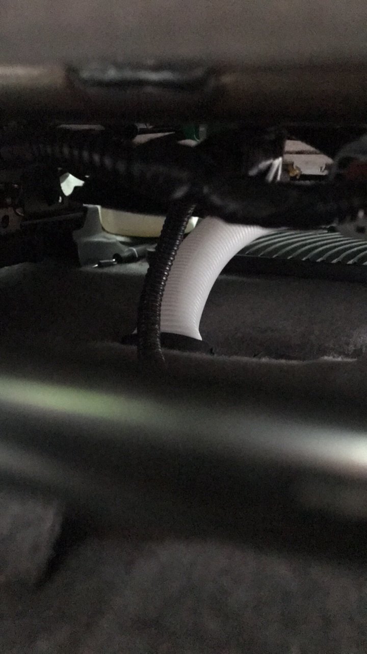

    Good news: I figured it out. Forgot to post here, sorry.
    It’s VERY effective, like 20° cooler. See post 79 in my build thread:
    https://www.tacomaworld.com/threads...practical-trd-pro.491971/page-4#post-16037770

    The mod I figured out directs cold air into the seat bottom. I'm not sure where the seat back gets its air from and this does seem to help the back somewhat, but not as much as the bottom.

    That's the great part, it doesn't go in the seat. This way you don't have to worry about sliding the seat forward-back and breaking the connection, cause there is none. It simply deflects the air directly into the seat fan intake, and the fan then shoots the A/C'd air right through the seat to cool you down.

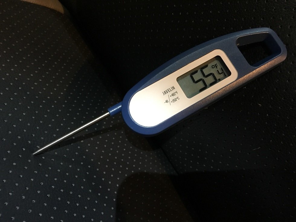

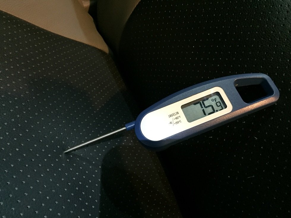

    Low tech low cost solution:
    727F366F-0803-4770-A688-509B7A3996A4.jpg 00324D97-85B3-4A9F-A175-F99C97DE6912.jpg
    Now that one spot on my ass is cold
