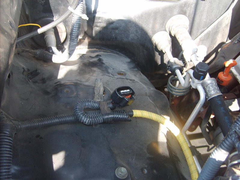

    Hey guys. I would like to say hi and let you know that I am new to this forum and appreciate any help that I may get. I have wanted a taco for many years and happy that I just bought a '01 6 cyl. She's a beaut! Upon purchase tho did not second guess a toggle switch under the dash and thought that it was for fog lights. Just a few days after buying her I was playing with the switch going down the road and thought I noticed that I had more power going down the road with it switched off. Later a check engine light came on and my air conditioning stopped working! I freaked! Took it to Auto Zone and the code was for some general heat and air trouble.:confused: So they were little help there. Long story short the toggle switch was a by-pass for the air conditioner. There used to be a box mounted on the back side of the passengers fender. It is gone now and I noticed a wire running from the air conditioner to the toggle switch under my dash.:mad: Where the missing box (?) is there is now just a plug tapped off with a plug for it that is oval. This must be for the controls to turn the air on and off? And what is it called so I can look into getting it put back the way it was suppose to be. Auto Zone had no clue.:confused: One last thing, is it hurting anything with it continuously running on or off from the toggle switch? I think that is what set off my check engine light, but it has not done it since. Thanks for your help guys!! Rock on Yota lovers!

    Welcome! Can you post a pic of the locatiopn you are describing?

    S5000896.jpgThe plug and missing box is on the passenger side near the firewall. If I could get a part number from someone that would be great!

    Thats where the ABS system goes......looks like the whole thing is missing.
