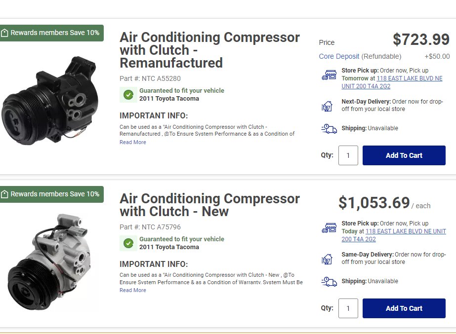

    They used to be common, odd.
    Looking at rockauto I'd be fine with any of the choices except the cheapest 4 seasons model.
    Looking at napa (canada prices) here is an example of what we refuse to run
    The black coated compressors ALWAYS give us trouble. Stay away from them, regardless of brand.

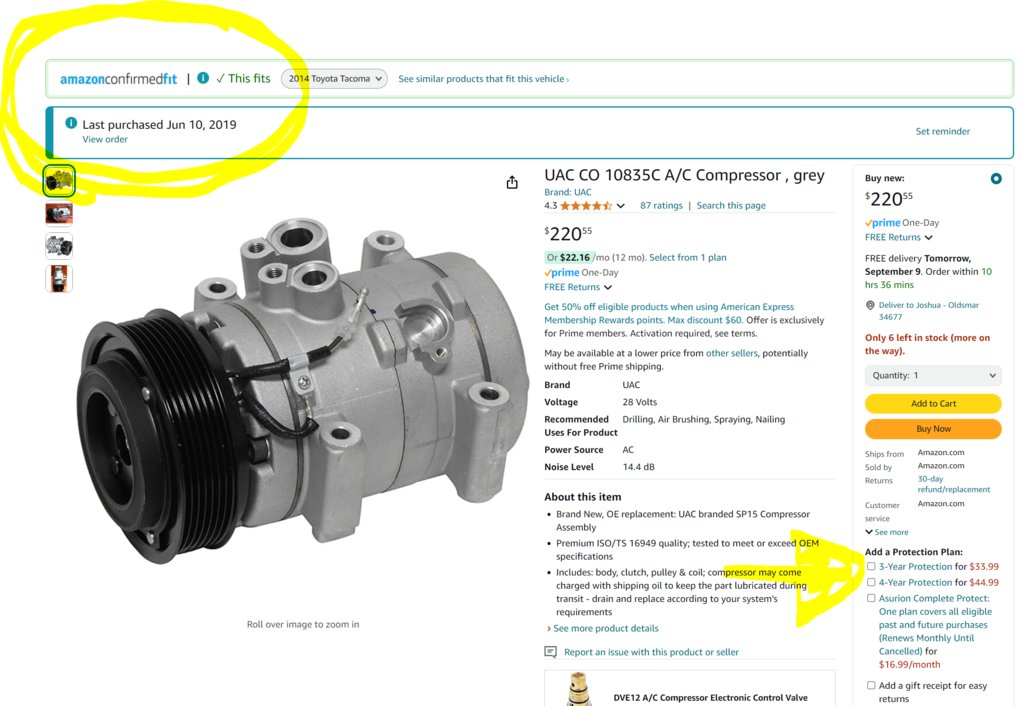

    Kodiak,AK
    2014 DCSB PreRunner SR5
    I order a UAC back in 2019 because I had no other choice at the time, and it has been going strong for all these year. Just a heads up, The dealer told me that my compressor had failed. It was right before a move from Florida to Alaska and took the dealer on face value and ordered everything while I was waiting for them to finish up. In the end after I had everything apart it ended up being a 17 cent oring that had failed an let loose all the refrigerant.
    Just a few tips. Remove the LH fender wheel well. It makes life way easier. Oreilles will lend you the vacuum pump and gauges for free. Chris Fix has a video documenting this exact replacement that was really good. He just left out few things but nothing to bad. https://www.youtube.com/watch?v=rulXlnG2Unk
