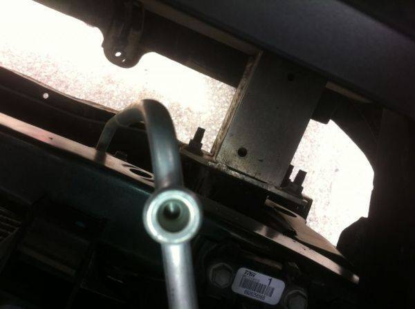

    Hey guys need a little help here, noticed that since it has gotten nice and warm out that I used my AC and it is not blowing cold air, sometimes it gets a litte cool but thats all. I have searched Tacomaworld and read thread after thread with no help. Things I have checked
    - switch on the coolent line
    - the compessor is moving when the truck is on, but once i click the AC button I dont feel the engine engage the compressor ? Could that be cause there is no Freon/fluid in the AC lines (look at pic)
    - cabin air filter is clean
    - I pushed the shredder valve for a sec and no pressure or fluid came out, I am guessing no fluid in there
    What should i do next ??
    This is in front of the radiator between the bumper, looking from the top of the hood.

    Go to a dealer.
    An A/C check should only be a few bucks. I wouldn't screw with those Autostore A/C kits. They are $40-$60 and you'd need two cans to refill a depleted system. A dealer will charge $90-$140 to recharge a system, and pressurize it correctly.
    I just replaced my condenser because it got a hole in it. When my A/C went out I had a dealer check it for $35, then I bought and replaced the condenser myself (saving $1,200). I'm scheduled to have the dealer recharge the system for $110.

    Have it either pressure checked with nitrogen or vacuum checked to find your leak. Usually with pressure it is easier to find with some soapy water. Then proceed with repairs as needed.
    Just make sure not to use any of hose quick fix cans from vatozone or the like. Enlist the help of someone who knows how to properly measure the correct amount of charge for your system.

    Just a word of warning, you should NEVER mess with the schrader valve on an AC system. Those valves can stick easily if not properly pressed and the refrigerant could then blow out and burn your hands/face/eyes if you are not careful. AC systems are not something to play with if you don't have the proper tools.
